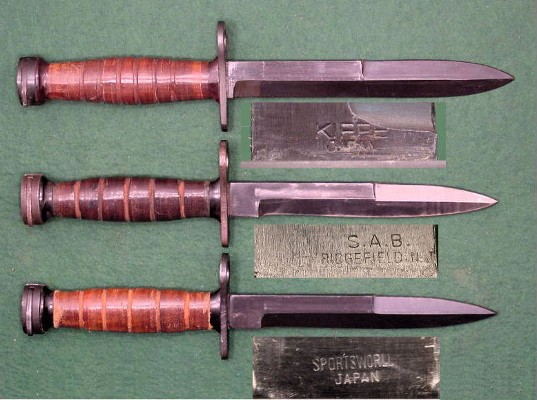

I bet it was one of these.
My father’s issue M3 trench knife has a Parkerized finish, IIRC. Once oiled, it almost looks like a blued finish.
My worn out 1911 has a finish that is more of a grey. I wonder why the difference.

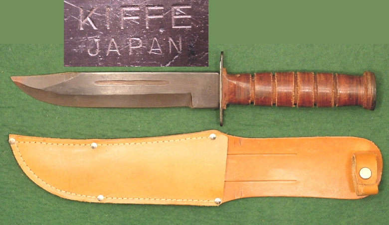

Back in the late 1970s, I went with my dad to a military surplus store and he let me get two knives there; a Japanese-made Ka-Bar clone and a bayonet. Both blades were blackened (was it
parkerized?). They were carbon steel blades, and the finish was pretty durable. Actually, for a Ka-Bar clone, the lookalike was pretty decent quality. Both knives were bought at that store for only like $5 apiece. I don’t know how old they were at the time I bought them, but they were in new condition, so military knives were being made with blackened blades well before the ‘80s.
