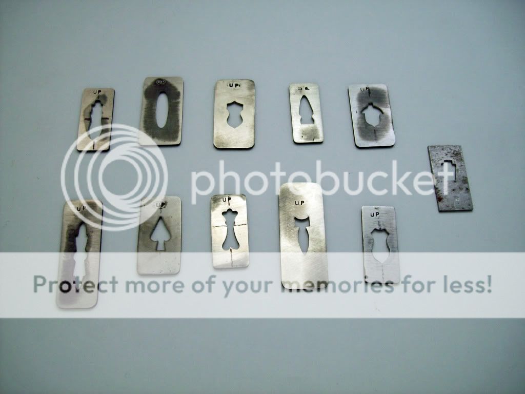

Heres a lineup of my current shields. I hope to add "dogs head", "star", and "cloverleaf" this year.
Left to right Double Bomb, Oval, Badge, Arrowhead, Acorn, Gimp, Ace of spades, Bullocks, Single
bomb-Rocket, Federal, Keystone. I usually pry one I like out of an old knife trace it onto 1/16"
ats-34, then file them out to shape and leave them "ice hard" after heat treat. Hence "Sole
Authorship" and not 100% symmetrical. Only 2 requests for no shield in 4 years
Ken.
