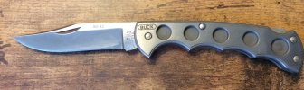

I’m curious if my 560 was during this time. Although I seem to think it was earlier than 2002 that I sent it in for the upgrade. Really do like the Buck BG-42 steel. I should have done a couple other Buck’s at the same time. Hindsight right? :)
IIRC, 110 blades with BG-42 were offered in the 'custom shop'. Lots of folks on the forum at that time were crying for BG-42 for the 112, but, it wasn't offered in the CS at the time. I think Joe and or Jeff took pity on us and had the 112 blades done and informed the forum members of it's availability. Preston
Aha.. D-rig that is a crown jewel of any 112 collection. .Is it pukka shell handles? Definitely one of the best custom 112's I've ever seen. Super rare blade AND rare handle too. .Particularly in a nickel silver frame. It was like it was all meant to be together. Preston BG42 for a 112 was never a option in the Custom Shop in the recent era or in the brief window in 2008. I have never seen or heard of BG42 being a option or put in any 112 in the first era either. It just might have been possible. The only blades that were ever produced that I know of was this upgrade program in 2002. And from reading old thread's from that time period Buck sold out very quickly too. 200 blades ever made. .No wonder that they are truly rare and offered for sale. That's why I consider it a trophy quest for 112 collectors.
I edited my post, hope it reads correct now. I didn't mean to give the impression that the 112 was offered in the custom shop at that time, it was not. The CS had BG-42 blades for custom 110s or you could send a 110 in and get the blade replaced with a BG-42 blade. I did that with this one, and again sent it to Leroy for finger grooves. Preston
