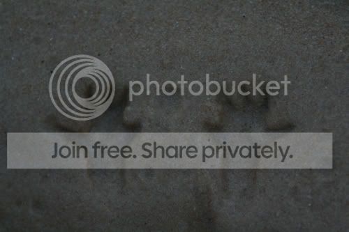

post one of the blurry pics mate - and allow us photo geeks to diagnose your problem
Where are all the photo geeks now ? You asked me to post one of my bad-uns and now no replies !!!!
Hmmm - let's see... The shot is definetly out of focus - so you could be holding it too close to the track. Check if your camera has a macro mode, usually indicated by a flower symbol on the command dial.
There is lots of shine on the wet ground around the image so it appears your flash has fired; which indicates it was a bit dark. Yet the twigs in the image haven't smeared in any direction so there doesn't apear to be camera shake caused by a tool slow shutter speed. If you camera is a point and shoot then I doubt it would allow a low-light shot without triggering the flash anyway.
Apart from the focus distance the flat, featureless surface might be a problem for the autofocus. You might like to try manual focusing or putting a stick over the track and letting the camera focus on that before locking the focus (usually by half depressing the shutter) and then moving the stick away to take a shot.

Pitdog, I'm going to disagree with just about everyone who responded. It looks to me like the camera moved during the exposure. If you look at the bright spots (which look more like reflected sunlight than a flash to me. The shadows look wrong for a flash picture) you can see that most of them seem to be double one above the other.
So I'm guessing that the problem is too long an exposure time, or the lack of a way to steady the camera.
