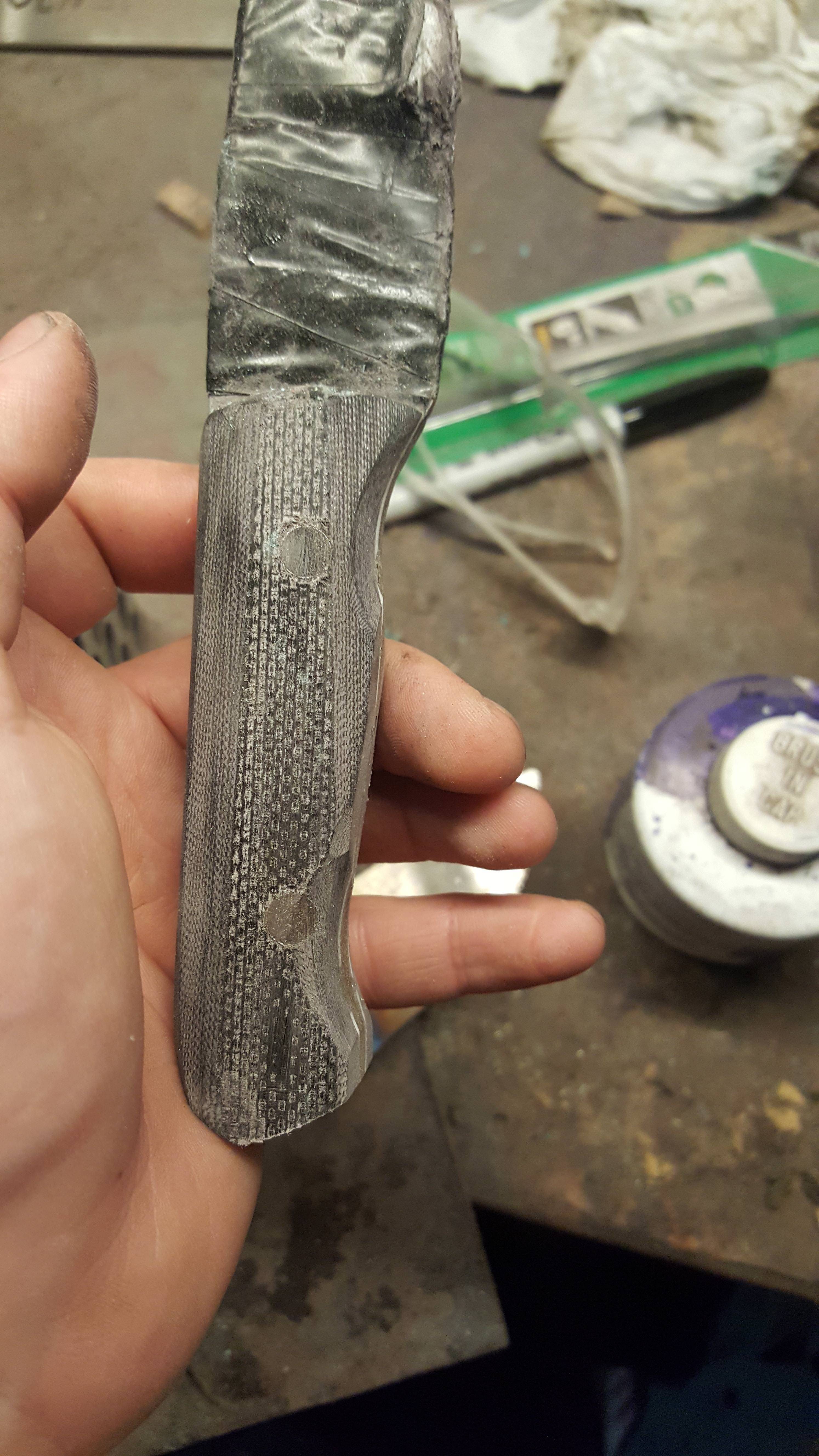

After setting aside my first knife making project about 5 years ago (ouch!) I decided to dive back in.
To make a long story short, I've completely messed up the handle profile in two ways, through my own ineptitude with an angle grinder.
1) Relief cut that hardened the steel AND went too deep. Now my file skates across it.
2) Grinded a gouge in the flat side of the handle.
Five years later, the design itself no longer speaks to me anyway, so I'm considering setting it aside and starting with something fresh.
When do you set aside a project and start over/move on? Any advice?

The biggest fear of a newer knifemaker is not being willing to break/grind the handle off a bad blade and going back to fix it right. The handle is only a piece of wood. When doing a large batch of knives, I scrap at least one handle every time. If the shape it isn't right, or I grind into the inner epoxy filled recess ( yes, we all do that), I just remove the handle, clean up the blade, and re-do it right.
Here are several places newer ( and some older) makers often decide it is hopeless. In all these cases, taking the handle off and fixing the problem will usually end with a perfect knife:
Handle not aligned with blade after the epoxy sets up. Happens more often than one would think.
Blade gets nicked or badly scratched in handle grinding. Covering blade with several layers of tape while working handle can decrease this risk.
A flaw, inclusion, or crack shows up in the wood while grinding it. This is common with burl wood.
You over-buff a handle and the wood crazes ( tiny cracks all over it). This is a big problem with ebony and ivories.
Blade/handle shape not pleasing once finished. Never say, "Oh, well, it's good enough", go back and fix it right ... even if that means going back to step one.

It is very true that as you gain experience and skill, pieces you once thought were trash become salvageable. New makers don't always realize how much meat there is on the bone and how much correction can be done with a blade. But there are definitely instances where a blade or knife just isn't worth the time. Sure, you will learn lessons from attempting to fix knives that went horribly wrong. But you don't always need to fix the problem on that knife to learn the lesson. We often forget that the materials aren't the greatest investment we have in the knife. It is our time that is the greatest investment. We can get more materials, time we cannot. Learn to assess which mistakes are worth fixing and which are not. Make mental, or better yet, physical notes about lessons learned and apply those lessons to new knives. If a knife is worth fixing, by all means, do fix it.

Last night I performed some delicate surgery on the blade in question with an angle grinder. For me, as a total newbie, it was a bit of "getting back on the horse". I'm happy to say I removed the "burnt" spots and spent some time filing. I came to the realization that as my first blade, I'd much rather see it to the finish line, warts and all, than strive for perfection. I figure that will come with repetition.
I found the filing last night to be very relaxing and enjoyable! I'm also starting to see the value in having multiple projects going at once, in order to suit my mood at the time.
Here's a pic of it on my filing jig. I'm thinking of reprofiling the handle to remove that odd looking curve and I started messing around on the bevel, just to see how it would go.
