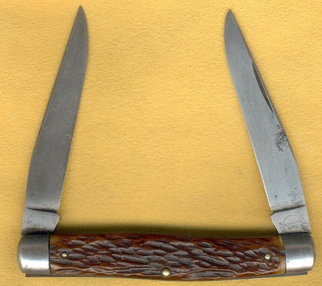

Back when we were discussing some aspects of bone jigging:rolleyes:, I actually went out and bought this Remington Muskrat;

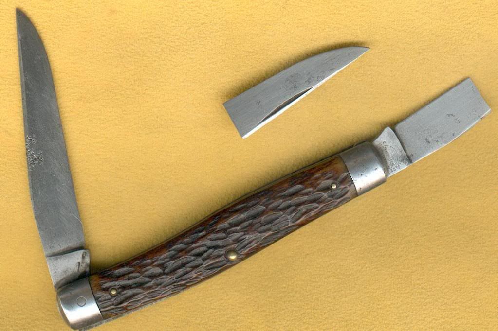

It is (was) a nice Muskrat, but one blade rubbed the liner, and slowed the closing snap. I could feel the spring was good, so having more bravado than brains I thought "I can crink this puppy!" So I went over to my trusty stiddy, laid a piece of leather over it, set the knife across the step, and with one little tap I snapped the blade!!:eek:
I quickly went out and stomped around the block before I broke something else, and convinced myself that all those years ago, Remington screwed up the heat treating!!:grumpy:

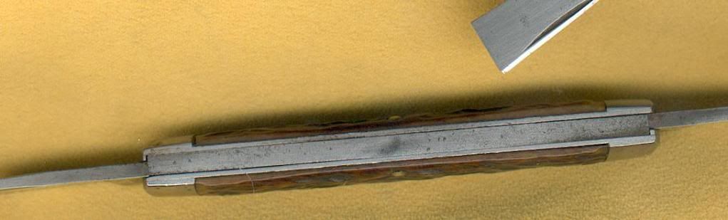

Anyway, I came back home, and being an optimist (some days, anyways) I decided to make some good come of this. I have a knife or two with blade(s) removed, that are darned useful, so I decided to go that route;
My! Look at that thick backspring!!

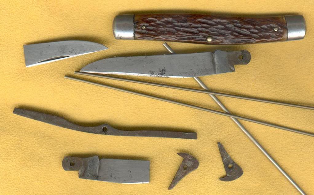

Back to the workbench, I took a thin but tough old kitchen knife, and tapped it through the pins, and deconstructed it! Seen here, with some pin stock for re-assembly.
Boy, look at all those parts! You can see the catch bits, that fit the blades to the larger spring trough.

WOW, that is a heck of a heat treatment. Did they just forget to temper. Or is there something that caused all the martinite to form?

Charlie, Take that blade and have it Tig welded using another old Remington Blade for filler. File the weld down, straighten the blade, flatten the back spring on a flat surface with 220 grit paper so it is straight. Make sure both tangs are flat and see if pivot holes are square with tangs, after all of this is done reassemble blades with pivot pins, insert back spring clamp down insert center pin and see if all is working properly if so peen and spin pins.
Then say man look at my new carry knife....:eek::D:D:p
PS If you want a one bladed knife you will have to make a new back spring... If not find another blade to your liking and make fit...:)

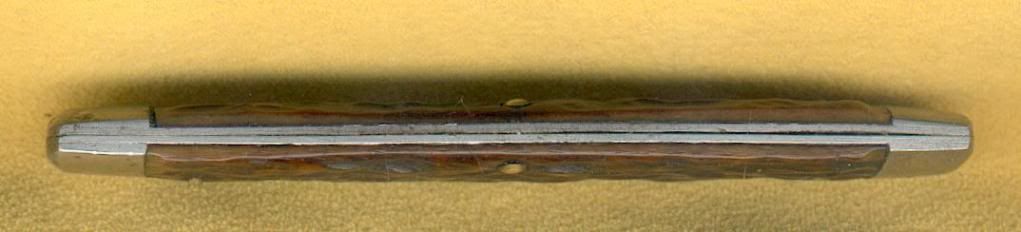

So you won't have to sharpen this knife!! Or oil the joints!, And only the terminally stupid will cut themselves!! And you won't - and this is important - you won't get any lint in it! And it fits neatly in the pocket, hardly making a bulge!!
I'm so excited - please tell me what you think it's worth!
Drum roll please!
Behold!!
The no-bladed pocket knife!!
Now be honest! Tell me what you think!!
happy april first!:p :D
