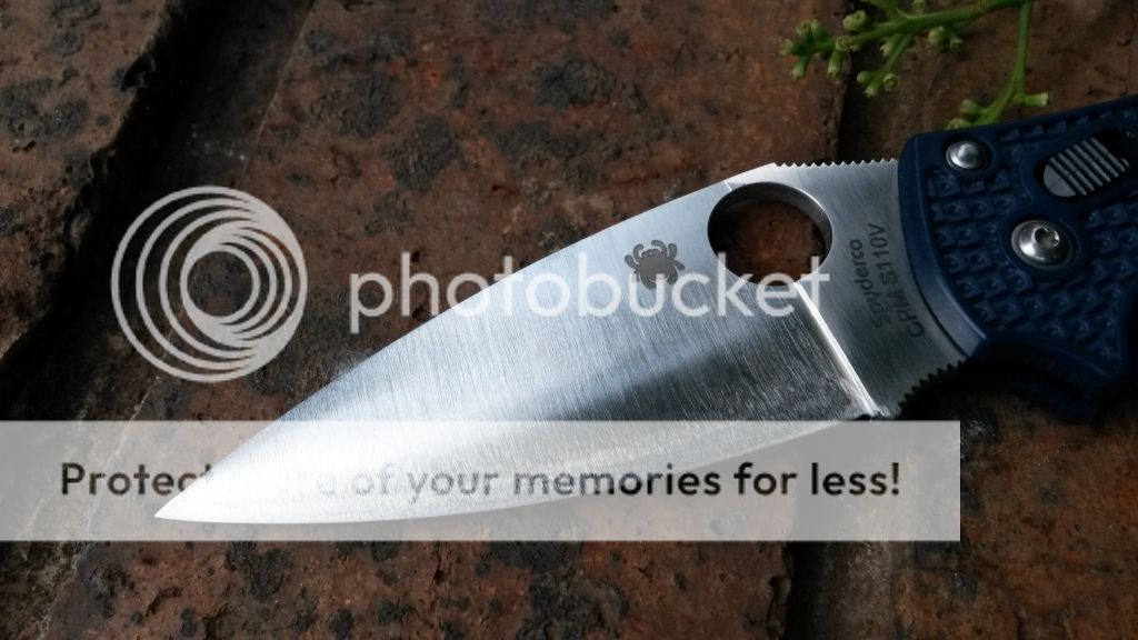

Here are a few pics of my manix reground with a swedgie
