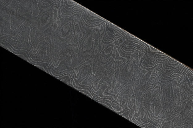

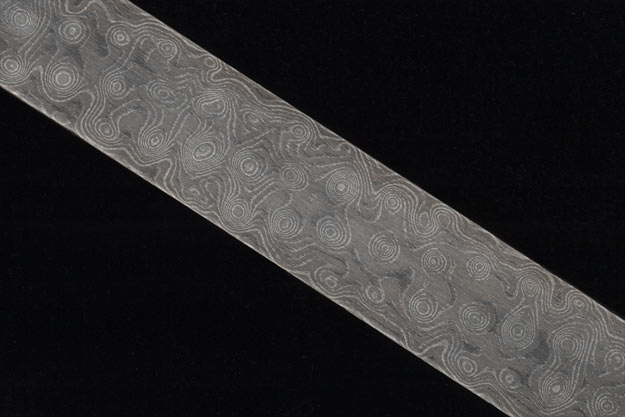

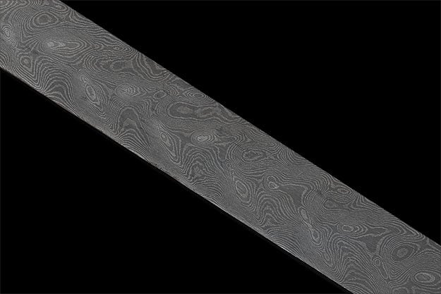

there is a young couple who live in Ephrata Washington who do very good work and can make about what ever you want as far as pattern goes. they are using good steel from kelly Cupples. I don't have a number for them but I will find one for you. here is a few photos of their work. their names are Matt and Michelle, Whitmus.
Some of theirs claims to be 1095/mild, some 1095/15n20. Even a bar of 1095/mild would average out to .5 carbon and harden to what, 55-57?
It's entirely based on proportions. If you have a straight 50/50 mixture that's true, but if it's 66/33 mild/1095 you end up with a different beast all together. Just a little note to remind folks that what steels plays just as important a role as how much of each is used.
