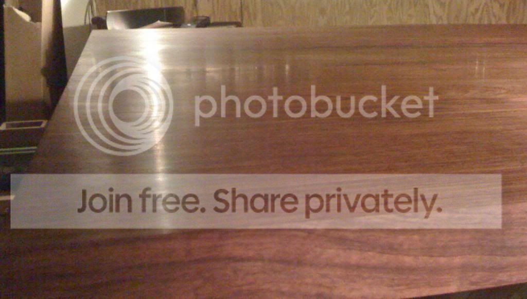

Here you go : the wood surface is cut so clean, flat and accurate it has a reflection to it even before any finish is put on. There is no finish on this table top , just bare wood right off the hand plane (never any sand paper) and no finish on the end grain on the same table up on it's end to plane the ends of the table.
So . . . to make the edges work the way I want/need them to they just turn out hair whittling. It's fun though.

Wow bagger, that is really neat. I didn't know raw wood could have such a nice finish right out of a planer like that.
Gorgeous work Bagger! I'd swear there was a finish on that wood!
