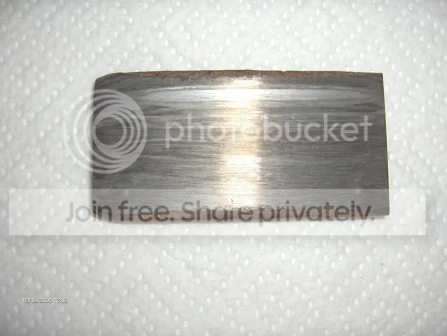

I have 500 lbs of wagon wheel wrought iron that should be here within a week. It is around 3/8" to 1/2" thick. It is very clean stuff considering it is over 100 yrs old.

I have never forged pure iron but the old wrought iron has to be forged at yellow heat to avoid splits. It is also brittle at room temp compared to mild steel.
If you forge hammered wrought iron enough you would work all the silicates out but I don't know how pure it would end up. It would most likely still have other trace metals alloyed in.
