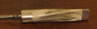

finally finished the test project - here's the result.
first, prepared the handle material to accept the pewter

melted to pewter until it was hot enough to cause a wooden match stick (used) to smoke - spooned off the dross (the junk on top) and poured pewter into form.
repeated the process for the pommel - here's the end result.
Hope these pictures help someone else. I know I appreciate all the help I got in learning how to do this.
