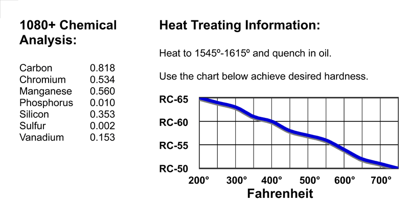

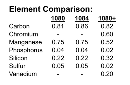

They are basicly the same but I like 1084 better than 1080. Some 1080 has carbon at or below .70%. Too low for me.
Here is a comparison of 1080, 1084 & 1080+:
If Aldo's latest batch of 1084 ever comes through it has a little bit of vanadium to control grain size (1/4 inch by 1 1/2 inch)
