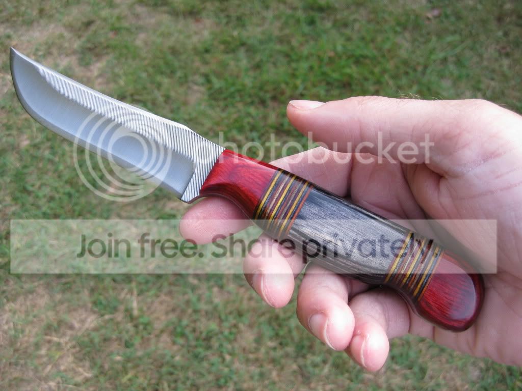

To be very specific, if Brian epoxies together several layers of sanded micarta, cuts them into scales and then epoxies them to a tang or folder liner, it will be more durable than most wood scales. The joins will be very strong, completely stable and unlikely to separate, even if someone was did something dumb like take a chisel to them.
See this:
That one piece scale is three layers of micarta, sanded and epoxied together as I've described. After curing I grabbed the front two ends and lightly pried them apart, levering the two joins. Despite 3" of leverage, the scales flexed and the two half inch joins didn't even crack.
I don't know what your standard for strength is, but my joins after sanding appear to be a large percentage of the strength of the micarta itself. Certainly strong enough to make a scale out of.

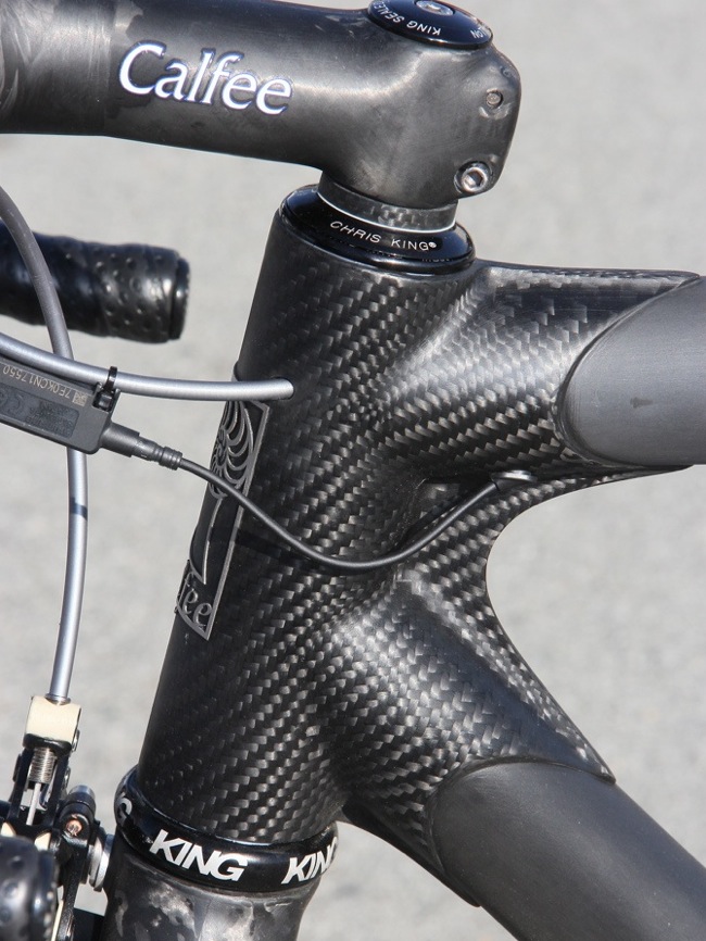

I think you're making a theoretical argument about something I do with composites pretty commonly. As I said earlier, phenolics and epoxies chemically bond to each other in a way that is not "adhesion". That's coming right from CS folks at a large phenolic supply house. It also jives with my experience building the one piece handle I posted about earlier.
And if you can stand to hear about bicycles some more, the type of lugged joint I posted a picture of earlier are always much longer with more overlap if the lug or tubing is metal. That's because (again) composite matrixes bond to epoxy through cohesion, while they merely adhere to metal.
First of all, that type of joint that you posted a picture of is a tube in socket with a LOT of surface area for epoxy, much different and stronger than a simple butt or lap joint. Second of all, no I can't stand to hear about bicycles some more. Third, you've misunderstood my reference to a metal tang serving as reinforcement. I don't care to generate the wall of text it would probably take to fully spell it out to you.
