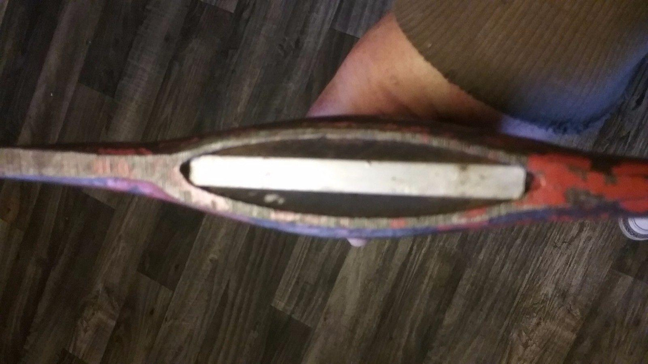

I’m going to try to save the cruiser handle. There is plenty of wood above the shoulder. I just need to get the head off. To do that I need to figure out a way around the steel wedge that’s in there. There’s no sign of a wooden wedge. At least not that I can see.
Drill couple holes in it and screw in some screws or if it is aluminum wedge than self tapping screws might do the trick
Yeah some small pilot holes and some self tapping screws usually work pretty well to give ya' something to get a claw hammer on for pulling.
No, it’s a small steel wedge that runs 90 degrees to that and nearly in the center of the eye.
