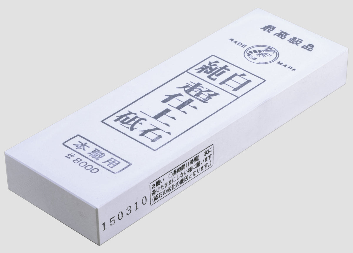

Imanishi Kitayama 8000
Naniwa Dressing Stone 600
Rust Erasers
Those all are very nice stones, except my bad experience with the Kitayama. I would encourage you to consider the Naniwa Snow White 8000 instead. I use the higher grit synthetics up to a 20k Suehiro for straight razors. The Kitayama has hard clay particles embedded in the stone that would not soften up and they chipped the fine edge. Maybe mine was an aberration, but I would not use another Kitayama if it was free.
Here is a link to the Naniwa Snow White 8000, which is a wonderful stone:
I think I'd go with the Suehiro Snow White Cerax version, because of the potential for cracking on the Naniwas. Also, Kitayama is alright but nothing really special, don't really like the finish.
