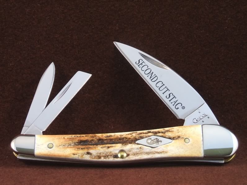

I know this is a Schrade forum but your question was, "Which blade arrangement constitutes a genuine USA whittler?" Thus, here's my chose. Go ahead tar and feather me. I deserve it.
Case's Seahorse Whittler
Jackie
I guess any arrangement of sharp blades that does the job for you is the simple answer.
Jackie, that 'Case' with the Master wharncliffe blade makes me just want to sit on down and start a'whittlin' mate! Nice!

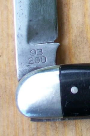

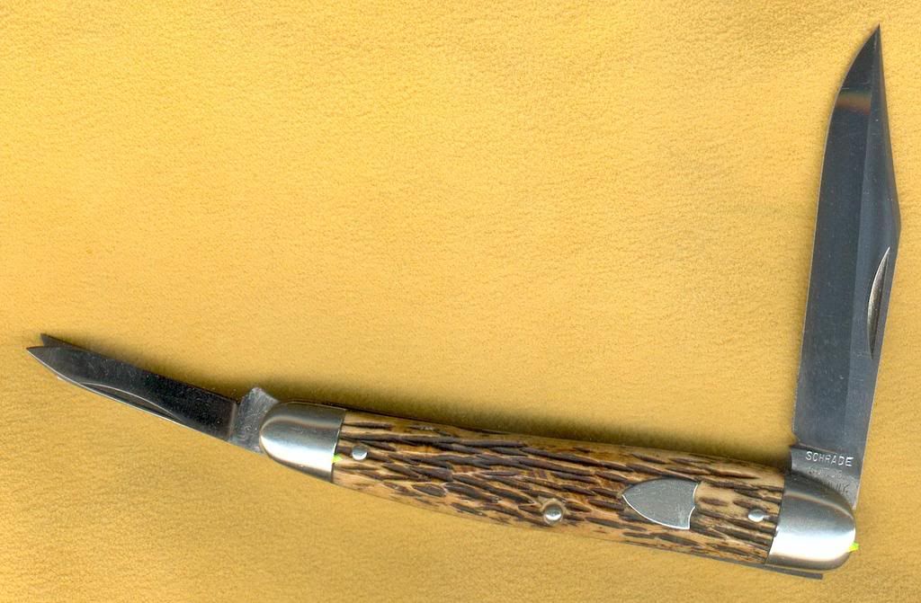

Nice collection there Larry! That big 'ol Cut.Co would be considered a cattle knife rather than a whittler, and I think the 58OT would be considered more a stockman pattern. The 804 (and its many variations) would fit the bill more than any other Schrades, complete with the split spring blade arrangement and all important coping blade. Todd, yours is the 8364, which was also available with a coping blade instead of the pen blade and went under #8363. This was kind of the little brother to the 804, which in Cut.Co #'s was the 81004 (confused enough yet?), by the way that # on the blade is not the pattern #. I'm not sure exactly what it denotes, but I've seen it on a number of Cut.Cos. . Anyone know what it means?

Also thanks for the info on my Cut. Co. as I was wondering why I drew a blank researching the "model number"

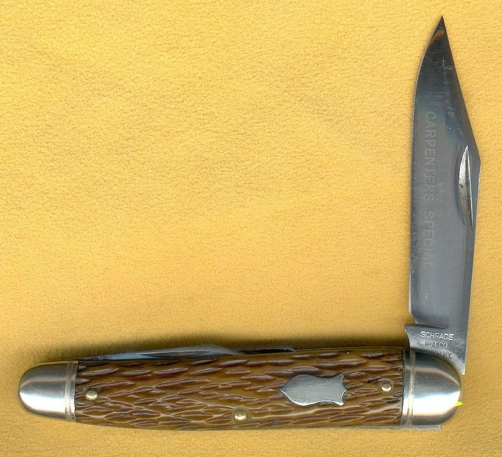

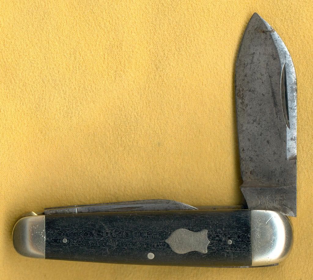

All marketing ploys aside, the cutlery definition of a whittler includes a split or paired backspring, with a heavier main blade riding both springs, and two smaller blades, one on each opposite spring end (or words to that effect). Every knife can be used to do some kind of whittling, but the confusion lies in how you use the term whittler. IMHO, if we call everything a whittler, it dumbs down the discourse, so I prefer to use the cutler's terms, not the marketer's. Here is a true whittler, 4" long, it's an 8323B, ca. 1936.

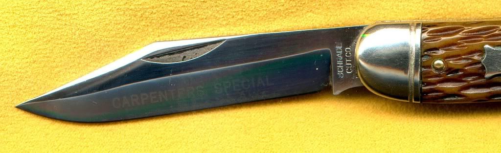

Eventually connected to Schrade, Ulster Knife Co. made this heavy duty Whittler, often called a Carpenter's whittler.
It's so heavy, someone used it to pound something, as you can see from the various "scars".

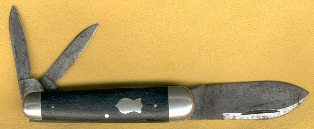

Just for you stroker, the wood butcher!
Incompetently photoshopped to show the saber grind and etch.:rolleyes:
Here's a smaller one, the "Sunday-go-to-Meetin' " version.

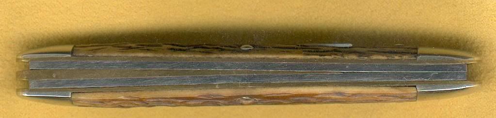

Here's a backspring pic, showing true whittler configuration. It is one of the hardest knives to fit and finish properly, and many old time collections focused on whittlers just for that reason. A whittler might cost two or three times the price of a regular Jack, back in the "day".
