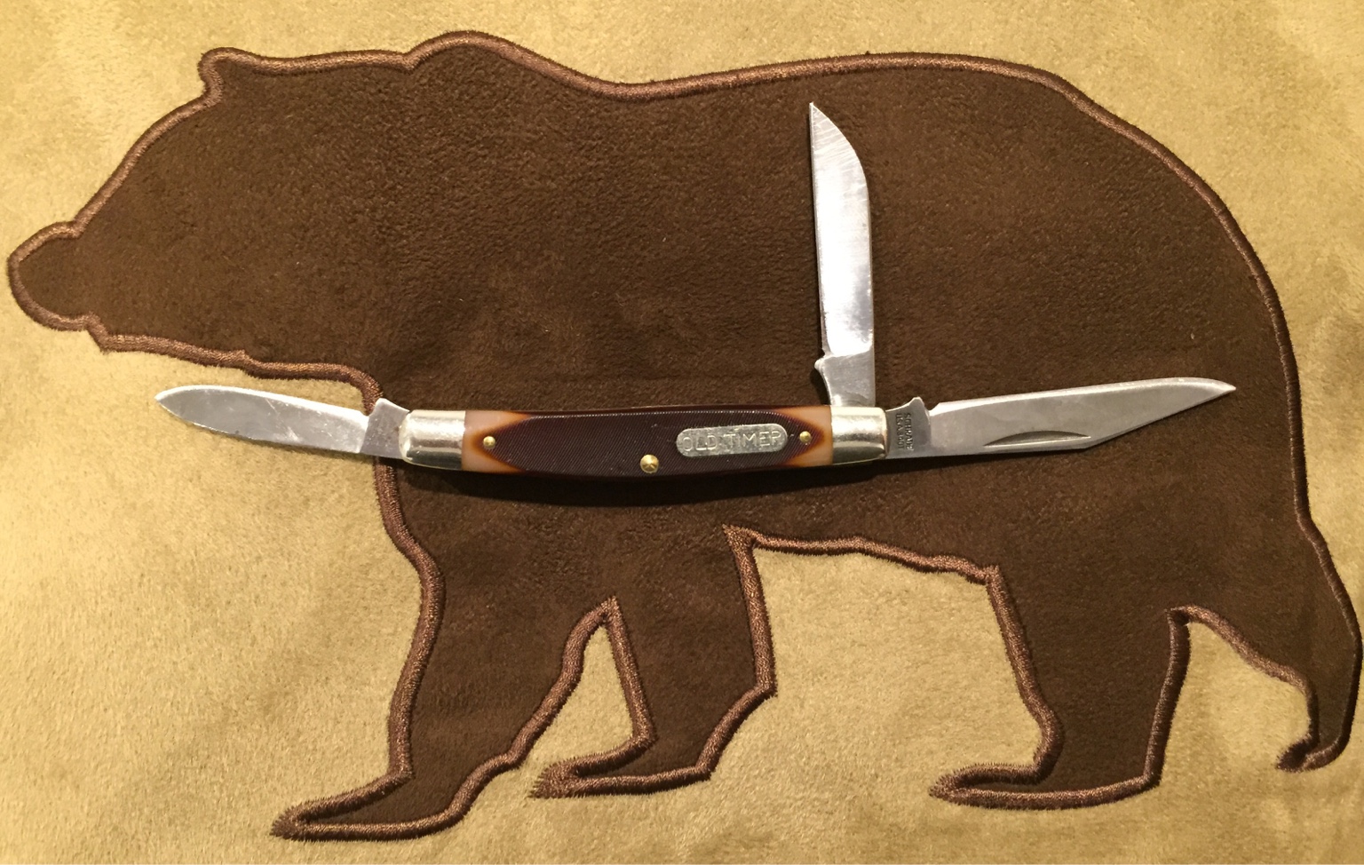

Which blade do you prefer on multiple blade slipjoints?
I'm really liking this blade combo at the moment. A nice full spear, and the secondary clip is so pointy and very useful
. I am curious to know how everyone else uses their multiple blade knives. Do you use one blade for everything, with another blade as a spare? Do you save one blade for cutting food?
