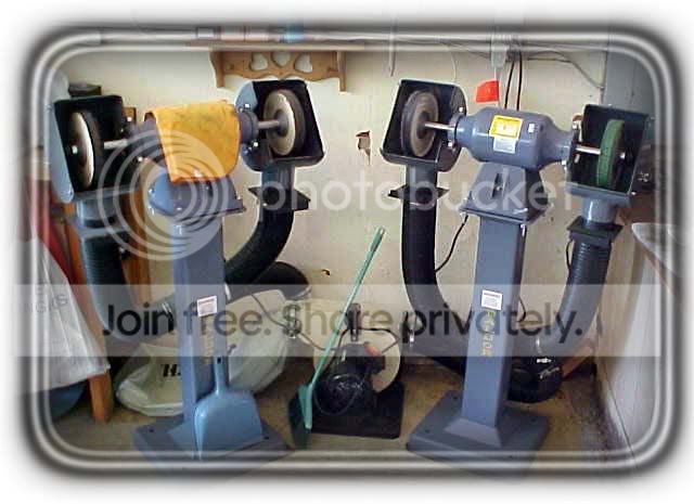

This is my buffers I use in the shop. Baldor 3/4 HP 1800 RPM. If you are going to purchase a buffer, I would go for something more in the professional grade. And order the safety shields for the wheels. You may find some use buffer on eBay and in some machinery supply that sale used equipment. But one of the most important things is be safe. And Welcome to Bladefourms. :)
Terry
