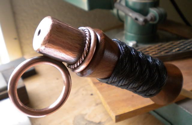

Here’s a new one I’m working on for a camp knife.
… Ferrule first… LOL
