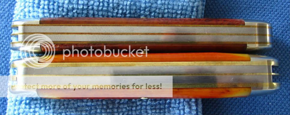

Just kidding, it would work best on the #53/54 or #68. I'd be happy if they'd just replace the spey blade on this #54 with a cap lifter. They'd have to lighten the pulls though, this is still my only GEC that I actually need to use a blade opener to save my nails... It is a thick and heavy knife though. See the comparison shots with a #53 Harness Jack. Maybe use steel liners instead of double brass for the scales? Would that actually save any weight? Maybe GEC will make a newer pattern in between the 3 1/2" #68 and 4 1/8" #53/54? Keep in mind that the Chocolate bone #53 is the same thickness as this green #53 Furtaker below which is the same thickness as the Victorinox Farmer...
