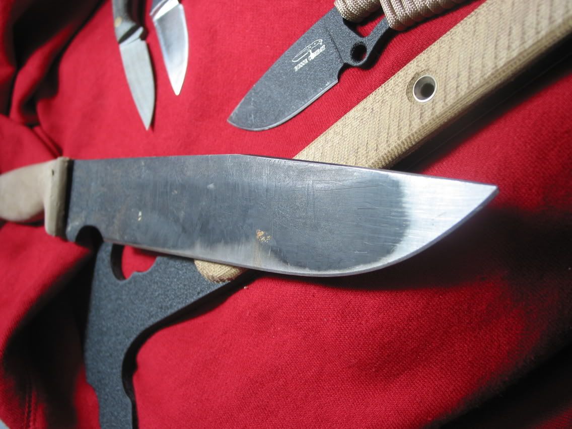

I have worn out the handle on my Battle Rat. I used it as a thrower (many hundreds of throws), and thus subjected it to many bad impacts that scuffed and battered it. Only cosmetic damage.
I then used it for heavy prying and twisting apart a large log, which stretched it a little, and the handle would rattle a little. I have since thrown it countless more times, and the handle is still in no danger of coming off, it is just a little loose and beat up. Very tough material. (and covered by the warranty)

Great video RF, must of bin a hoot breaking that BR in.
A well used Rat is a happy Rat.
