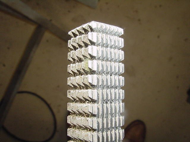

I wonder how a thread restoring file would work for this? I can find them in 8tpi and up, much cheaper than checkering files too. If just doing reeding on spacers, I imagine that any angle to the cut would barely be visable.
Here is a thread restoring file close up...
-Xander
Interesting thoght, Xander.
I have a 16TPI thread file somewhere. I migh try and find it and see how it cuts. My concern is that it really needs grooves to follow, and won't really cut clean grooves in smooth metal.
Update - Tried it - it won't work.
I have a 20, and sometimes wish I could find a 10. Like most have said, I don't really see much use in knife making for anything finer than 20 LPI.
Good luck. Thread cleaning "files" are pretty soft and not very keen. They're sort of useful for marking the spacing, then cutting the actual grooves with triangle files. Other than that I haven't had much luck; they cut so poorly that it's really difficult to keep the cuts even and crisp. That could be just operator error, though :o

Well, starting a line with a three corner file and then going from there might work.
I have seen vast differences in quality of these files just like regular files. I can see these possibly working on softer metals like Cu, Sn, brass and bronze, athough SS and NS will likely be too tough. Still think its worth trying as a proof of concept. Hope it works!
I had high hopes, but I had the same experieice.
Not worth owning.
