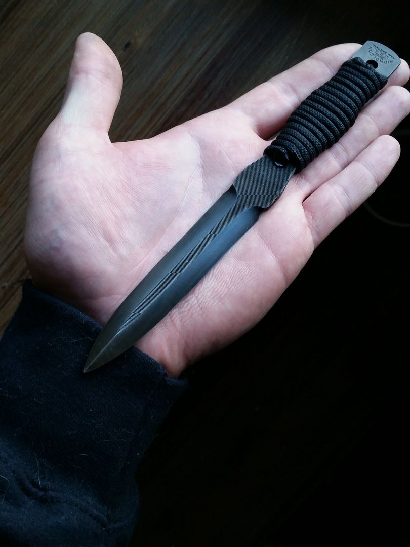

CM that dagger looks sweet :D

CM that is such a sweet dagger! And yes I do agree with you all that any steel would suffice for its intended purpose, thing is the steels I own are S30V, S35VN, and D2, and I would like to branch out and since I'm paying for a quality blade being made with me being able to choose a certain steel I think I'd like to try L6

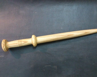

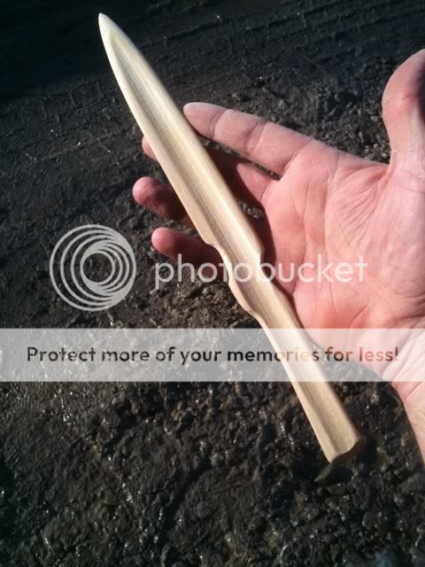

anything but steel:
bamboo
some unknown wood
koa wood
buffalo horn palm stick
a cup you can stab with (bet none of you thought of that)
