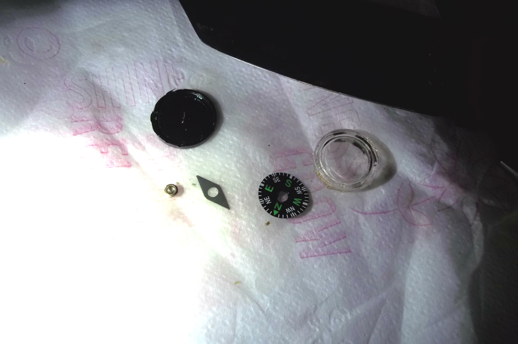

You know them little one that you sew under a button or in a shirt lapel or a seam. I've always wanted one 'cause I thought they were a great idea, a compass you always have. So instead of spending between $15-$45 I made my own. It's easier than you think, here's what I did.

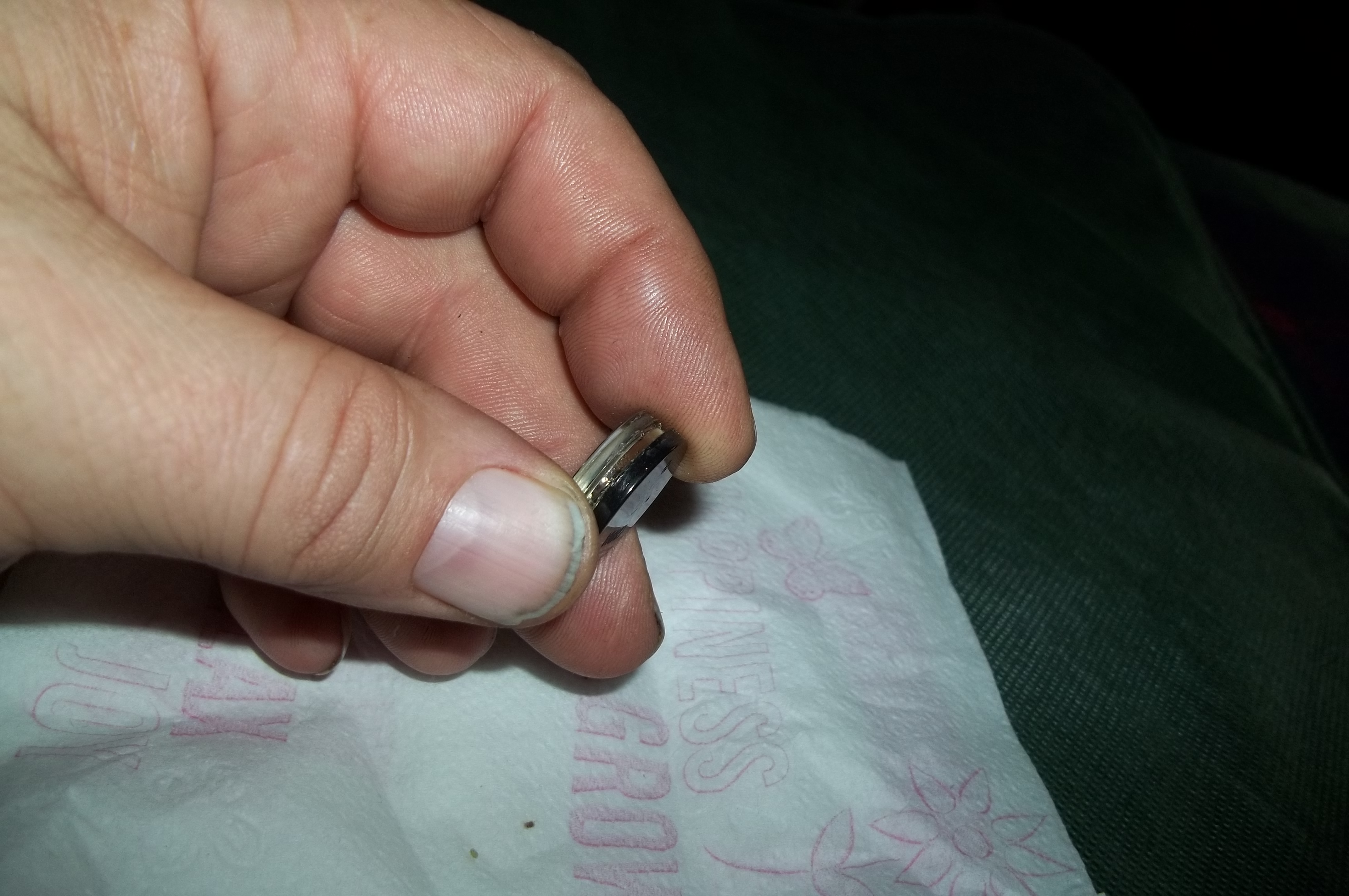

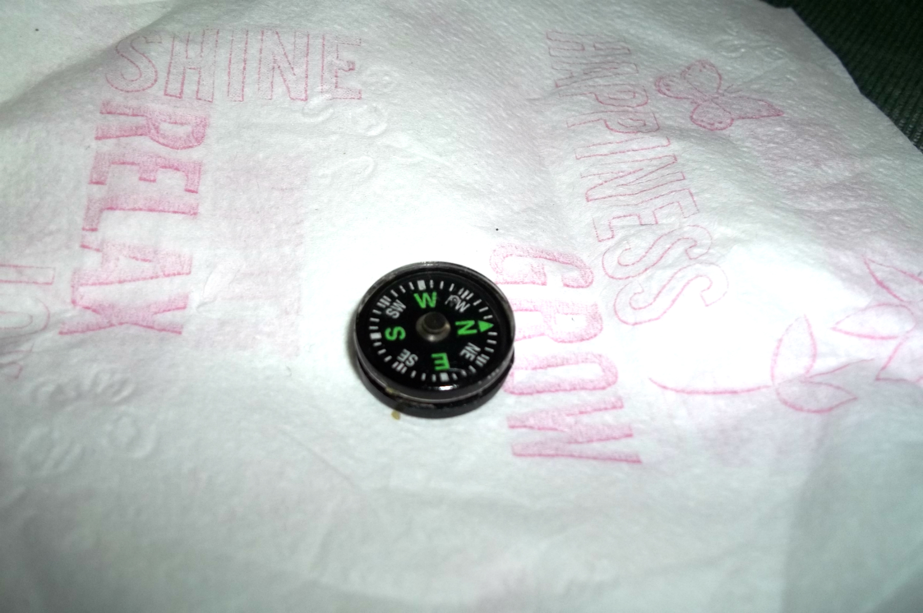

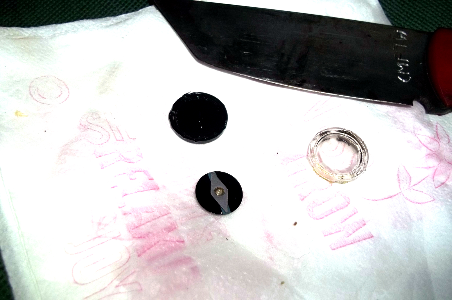

Get yourself one of those cheap little button compass, there ya go, now put it in your pocket, wasn't that easy? Just kiddin', anyway get yourself a cheap oil filled button compass usually about 50 cents and with a blade or screwdriver carefully separate the two halves and dump out the oil and contents. This is what you should see...

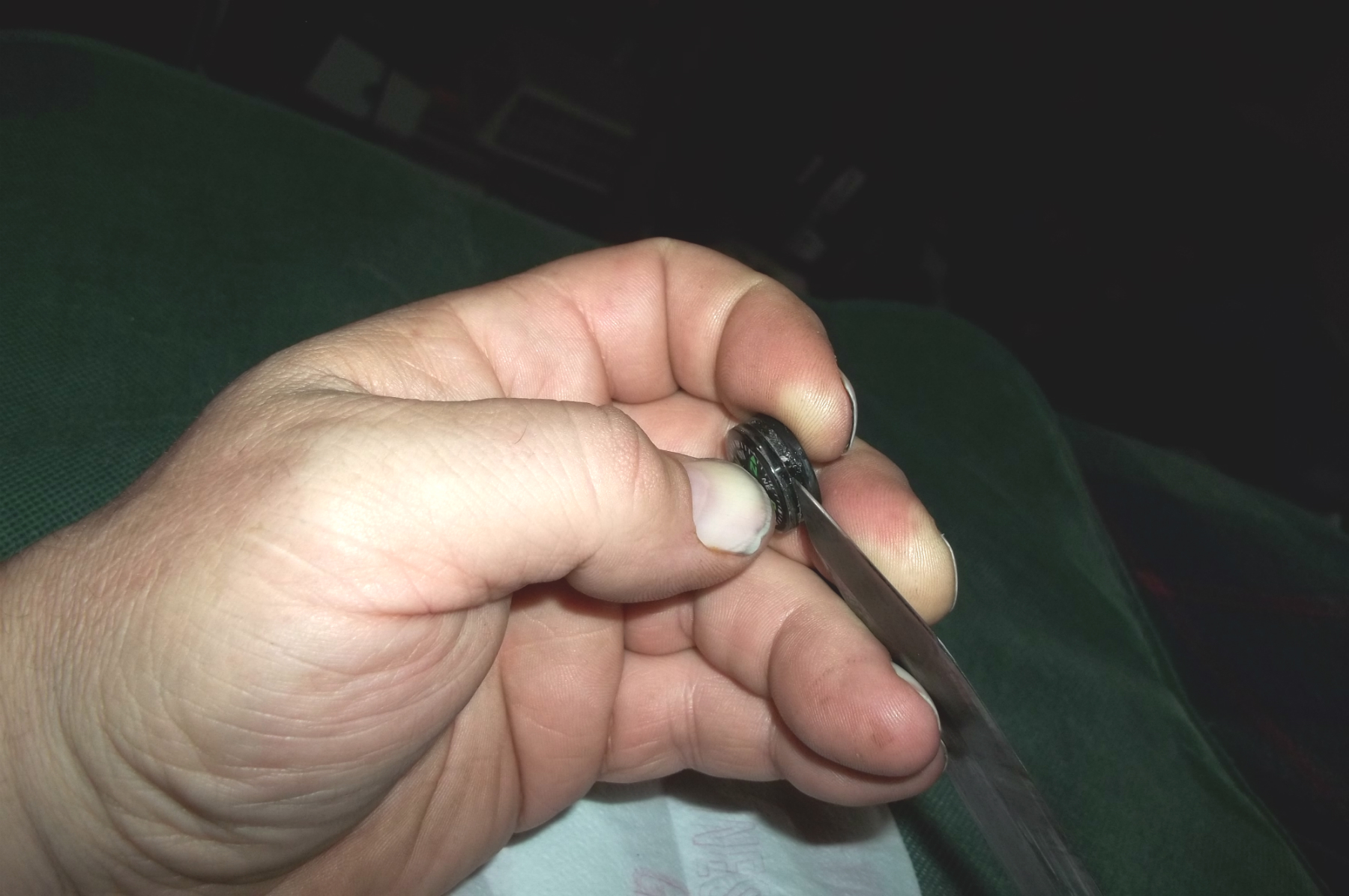

Now after cleaning and drying the parts remove the plastic compass rose from the pivot, this should just pull apart leaving a small diamond shaped piece of steel with the pivot button. Carefully grab the button and carefully work it back and forth till it comes off and you have this...
The diamond shaped piece is your compass, if you didn't mark north with a sharpie before separating the compass rose from the compass just find another compass and see which end attracts the south side of the other compass, that's the north side, mark it with a sharpie or better yet a center punch mark is more permanent and stash it till ya need it. When you need it just tie it to a piece of thread from your clothing or a strand of hair or you could float it on a leaf in a small pool of water.

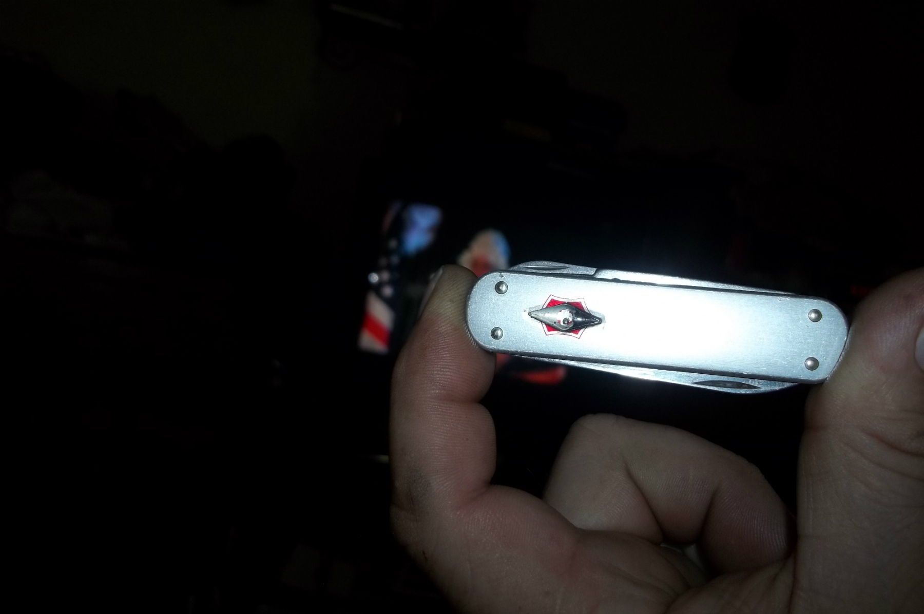

I mounted mine onto the aluminum scale of my SAK money clip which is clipped to a chain on my neck and always with me.
I had it glued to the aluminum scale for a month and it worked fine, I did over magnetize the piece glued it on, it's not in direct contact with any ferrous metals so I don't believe it'll affect it. I'll let you know in six months.

You could also make one by magnetizing any small piece of steel:
https://www.youtube.com/watch?v=0HqW5m9yzgM
I only suggest this because a tiny compass is so small that if you want to go smaller, why buy and break one to do it? You can also choose pieces of steel that are easier to string - like a tiny bobby pin shape that will clamp a string or hair under tension.
The real downside to these methods is that they rely on having still water or still air to dangle the needle in. If you are someplace dry and windy, getting the needle to reliably point while dangling on a thread is going to be a challenge.

If you already have a button compass, why destroy it to make another compass? The button compass is probably better than any compass you'd make from it. Just magnetize a sewing needle.
