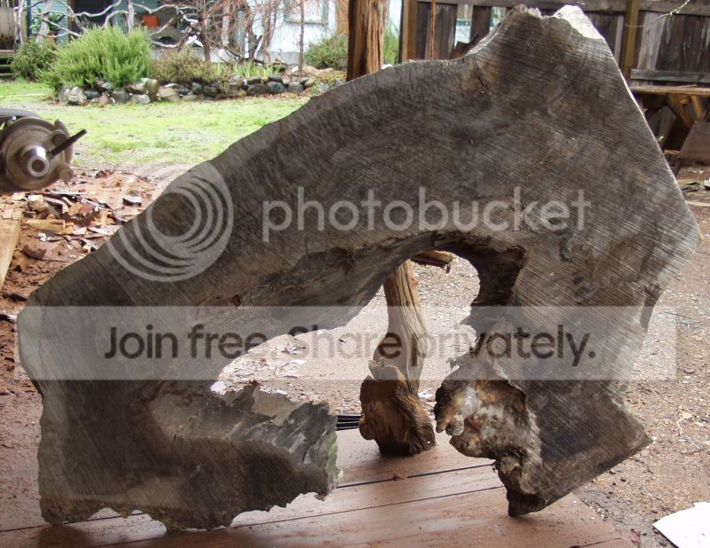

I need some advice from you guys. Instead of just cutting this piece as I see fit, I thought I would ask what you want to see.
This is a piece of real old redwood burl from a slab that was cut as close to quartersawn as you can get with a burl like this. The wood is considerably harder than normal redwood. It is tough to find redwood burl with a wide band of still hard sapwood. So I wanted to be sure I do this right.
I started with this big old crusty looking slab.

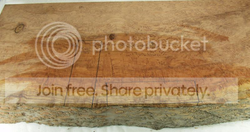

I trimmed away the wood that I did not think was suitable for top grade handles. And marked the slab with 2 possible ways to cut the blocks.

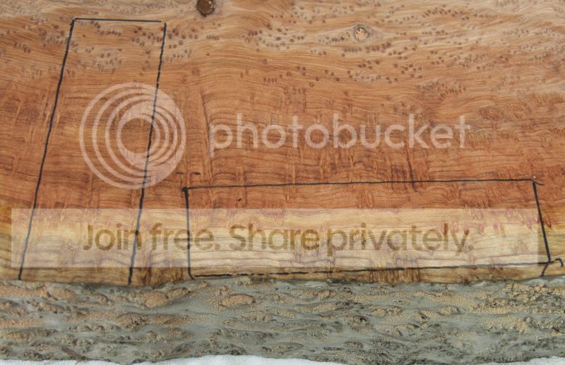

Here is a closeup to show the grain and figure better.
My question is "Which do you prefer?"
#1 Cutting the block so there is a section of sapwood at the butt end of the block.
#2 Splitting the 2tone colors the length of the handle.
I will be cutting this later today. Your input is very much appreciated.
Thanks, Mark
I think that both would be attractive. Two completely different effects. The one that is horizontal I would think would be a bit stronger and have a lot going on in the outside pieces, but wouldn't be as exciting in the blocks towards the center.
I think a nice burl with lots of figure should always be cut so the grain runs horozontal to the blade. About the only exception is curly maple, and heck, that's not a burl anyway. Just my two cents worth.
Dave
#2 is the correct way to cut for both strength and for the best figure. The reason I asked was because of past requests.
More opinions would be helpful.
Larry, If you are out there your opinion would be especially helpful.
Thanks, Mark
I think #1 would work better for a symmetrical blade, and #2 would work better for an asymmetrical blade (which is what most knives are).
Personally, I like #1 but I am a bit different.:p
I prefer #2 in or near the location you marked however there might be a place in the burl where #1 would look better.
I don't know how big your block is, but if it were mine, I would do some of both to maximize material usage (I usually lay out the whole block in pattern before cutting). I would use #2 for larger blades like chef's knives and #1 for smaller knives like parers or small hunters.
Just a thought, but it might look really cool to have the outside of the burl left on block #1 (the outside barky stuff). I might be tempted to leave that as the pommel on a hidden tang.
how thick is that board as i would think cutting it so that the sapwood would be say on the face of a block and having the most of the eyes one the faces and not the sides like the 2 cuts that you have shown
kind of like this bad draw i jsut did with the thin part on top and the wide face on the side
