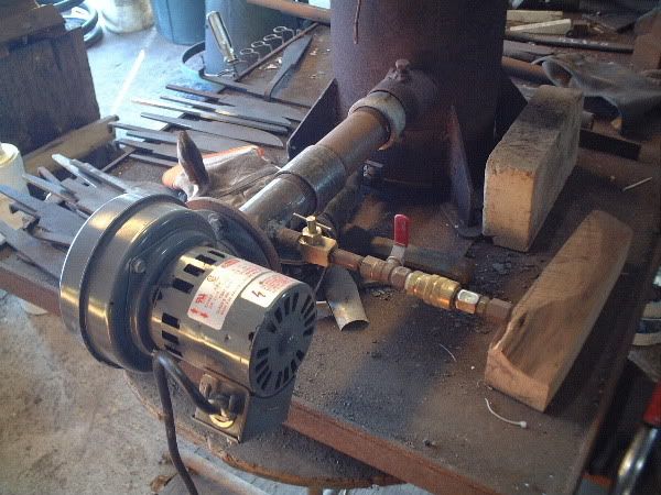

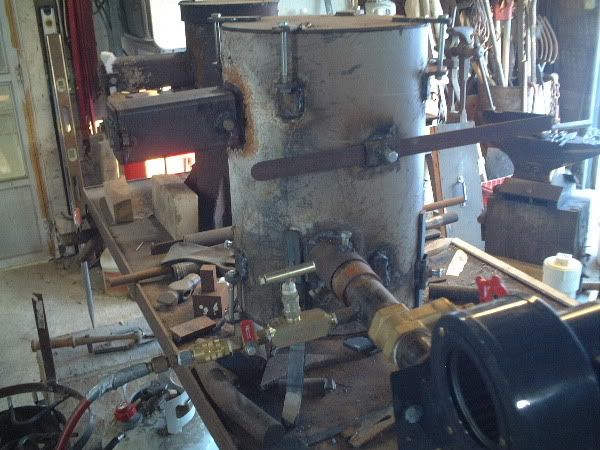

The pic is of the Vulcan's Chariot on a midnight run.
Vulcan is the God of the forge. Greek I believe.
I would like to see a sticky for forges somewhere in the makers forum.:) Anyone else?
I think the sticky would be inspirational to people wanting to build their own forges. Not a how to, just pics of your forge.
Share your forge pictures with us on this thread and see if we can get something started.
Fred
The forge on the right is for heat treating, it has a closed muffle inside it.
It has no name:)

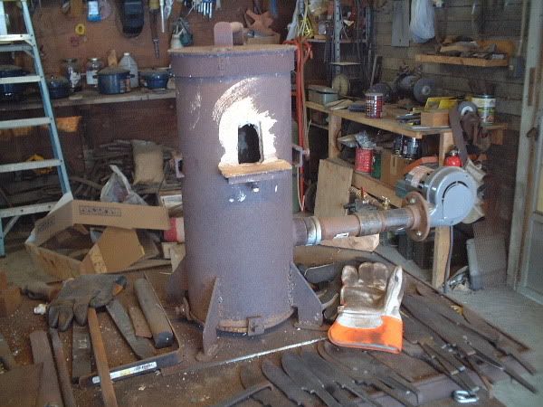

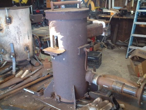

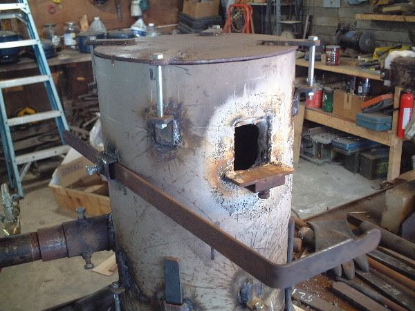

I use my small 8 inch one for forging smaller blades and the larger 12 inch forge for bowies and fighters, pattern welding and heat treating.
Both are forced air and I run them with 3-4#s of air and tweak them with needle valves.

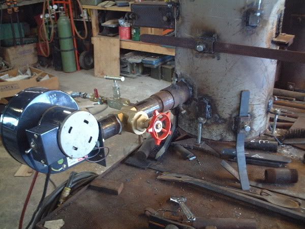

Here are some pics of mine. its not done yet! and i am thinking about the next one already. this set up was origionally for a couple of venturi burners but i have come to see that forced air might be the way to go.
i will finish it as soon as the wife gets done with school again and is back to work!
jake

Fred does the closed muffle work any better than an open one. I guess I am just asking for the differences. I am currently trying to set up a mufflle system, but it is an open one. I have heard that they cut down on oxidation.

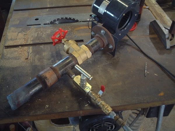

Both of my forges are blown; with the addition of an extra gas valve, you can make any forge, into an auto/manual forge. I estimate it adds a 150.00 to the cost, but pays you back with great control.
I am always trying to find ways to cut down on the amount of scale coming off my work. The closed muffle a [3/8" x 4" x 22"] stainless tube was set up to run argon gas, but I have never found the argon necessary. I put the blades in the muffle and let them come up to heat with the forge, give the proper soak time and get ready to quench. They stay scale free inside the muffle.
I don't think it would work to forge out of. To much hassle.
In the VC forge I built in good control over the forge atmosphere and keep it running a hair rich or at a reducing flame to keep the scale at a minumum.
I do know my blades come out of the quench a lot cleaner than they used to.
Fred
Fred thank you for the kind words. could you explain what you mean by extra gas valve and what exactly is an auto/manual forge. sorry if this is a stupid question but i'm very much a newbie.

I would be happy to go over it by phone. The drawing is complex, but the actual building if fairly easy.
My forge just got a little out of hand:):eek: this system can be a put together a lot more basic.
Pm me if you like, I have an 800 number I can pass along to you.
Fred
