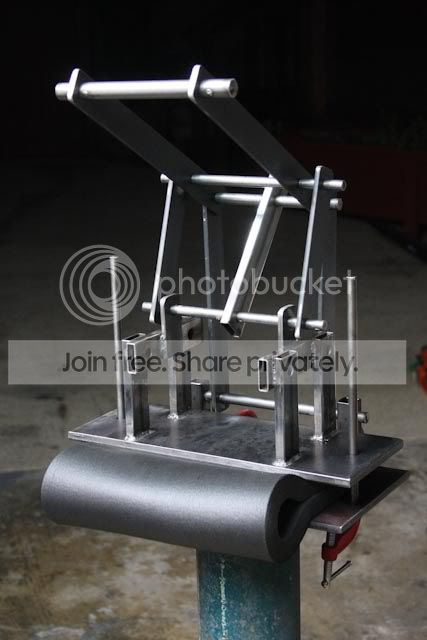

Well, admittedly, this is a bit much. I wanted to make a kydex press while I was waiting for my first knives to come back from HT. I've read that some folks don't like the hinged on one side type and prefer a vice-type press, but speed seems to be a concern in a standard vice. I bought some scrap metal to see what I could come up with.

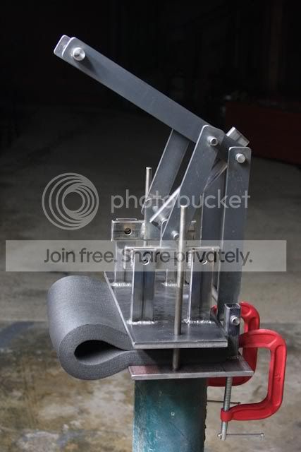

I determined I would probably not need bigger than a 11.5 X 6 inch bed, so I made it that size as the foam I had was 11.5 wide. I still need to cut and attach the foam.
I'm sure there's a better way to do this, but here's mine.
Stress test.
I need to add some type of locking mechanism, maybe a tie-down. This thing works pretty darn good and applies quite a bit of pressure. I'm not recommending this as a build, unless you want to play around and see what works. I haven't even made a sheath before, but like I said, my first knives are at HT and I needed something to do...

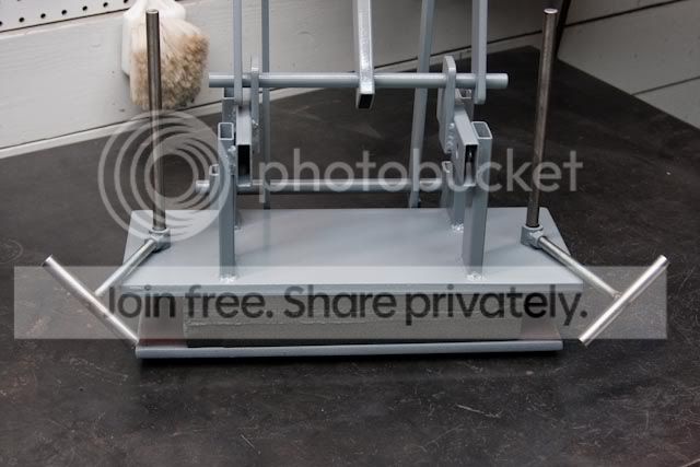

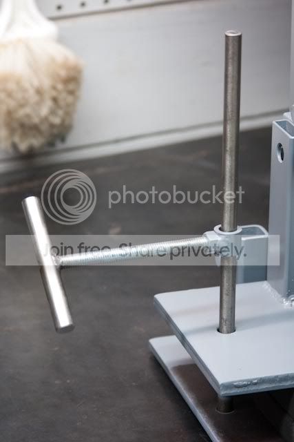

I decided to go "low tech" and easy on the locking mechanism. I wanted to paint it before the welds rusted any more. I may still play with a self locking set up in the future, but for now I am happy it is good-to-go.

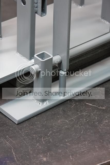

the next pic is a limiting stop which greatly improves the action when opening by not letting the upright bars lean too far back.
