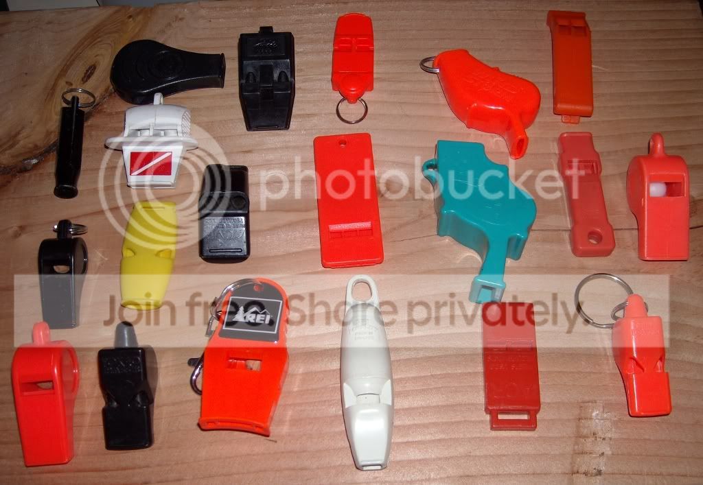

Howdy,
I have talked about doing this before, but it has yet to be completed.
I tested a bunch of whistles, and definitely had my favourites, but in doing the testing, I collaborated with two of my brothers and a couple friends, and we had some sticking points.
So, this is my idea.
Test the whistles, by utilizing the decibel meter which the local Sheriff Marine Unit possesses.
I think that the whistles should be tested both for their gross volume, but also for their net volume, when one is trying to hear them over ambient noise, at a distance.
For example, if the the searchers were near a creek or quakies, how would that affect the discernibility of the whistle tone.
Because, while many whistles were loud, it seemed as if some benefited not so much from their volume, but from their tone, which penetrated quite well.
Another consideration, or parameter of the test should be ease of use. If we assume that this test is to assess the usefulness and suitability of a whistle for survival use, then one has to consider lowered manual dexterity, loss of fine motor skills, numb lips, etc.
Anyway, those are my thoughts to date, and I am interested in your thoughts.
And here is an image of the whistles I have so far.....

after four years of lifegaurding i can tell you the only whistle to use is a fox 40, wet dry cold hot, they always work
from my somewhat limited experience as a sound tech/operator I know that a single frequency does not sound as loud as several with a lower actual sound pressure. Tone is very important, I'd say as or even slightly more so than actual sound pressure output. its just in how human ears work.
That is good information.
In my previous testing, I found that a whistle with two discordant tones worked best, it seemed to carry the best.

I have 6 of the whistles in that photo. IME whistles WITH a 'PEA' can be eliminated because the 'pea' can freeze in place and render the whistle a PITA/POS!
Some of the others are way too bulky, have some, forget carrying them PITA!
The Flat type work well, but are not as loud as the Fox 40's IME.
Anyone have any experience with the cord lock whistles? They attach to the ends of a paracord lanyard..
