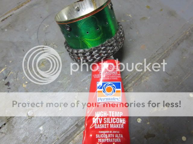

Nice review of the stove. They are simple to use and nothing to maintain. Another option for priming the stove is to glue a section of fiberglass stove gasket around the base. Just drizzle a bit of fuel on the wick (gasket) then fill the stove, place your cook pot on top and light up the wick. This works like a charm and you don't waste any fuel. The heat goes right to work for you:) The gasket adds a little weight to the overall package but this is a very reliable way to get the stove up and running under the most adverse conditions.
I just learned something. Thanks for this tip. :thumbup: :thumbup:
I'm going to try this modification with the stoves I make from some bottles that a gracious dude sent to me. :D
I like the stove gasket trick. Nice, thanks.

Daniel L, all I do is light the fuel in the primer pan. I think that's all you'd have to do with the wick that IUKE12 showed us.
