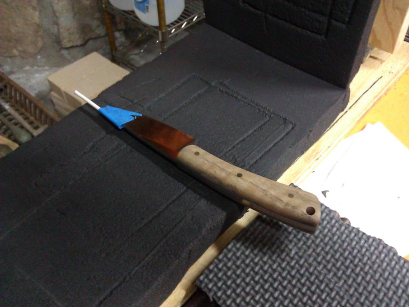

I think this one was sanded to 600 grit. I apologize the the lousy pictures.
before oil, about to get kydex:
after Tru-Oll

Nice handle daizee
