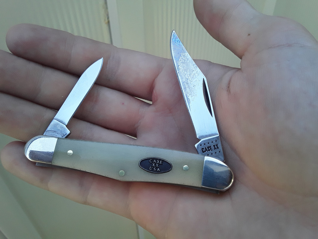

Does anyone have any advise for oiling white smooth bone knives? I usually oil the pivot area when I get a new traditional folder and work the action to smooth it up and lubricate the knife. This has never been a problem except when it comes to knives with white smooth bone handles. I use Benchmade blue knife lube, but it leaves oil stains in the white smooth bone handles (they seem to soak up the oil) after a couple of days. I do not overly apply the oil, and make every attempt to soak up any excess oil with a tissue. The resulting oil stains are unsightly, but I also don't want to live with a gritty action. Perhaps a different brand of oil or none at all?

Even if the oil you use is perfectly colorless, it can transfer dirt and verdigris from brass liners and pins into the bone. Perhaps a thorough cleaning with soap and water before applying the oil?
I don't worry about it too much, and just accept that white bone will show age, sort of like a patina on steel.
It'll look beautiful after a hundred years or so:
@r8shell Offers very sound advice, a good wash&brush up with warm soapy water and a toothbrush gets rid of the blackening compounds left over from buffing- oil just solidifies and dilutes them gradually. I use Coconut oil in pivots and to enhance shine on handles. another approach it to deliberately let your White Smooth Bone knives get exposed to Mineral or Coconut/Olive oils, they will soak up some-such is the nature of smooth bone, you then get this desirable yellowing patina on the handles.
Just make sure the knife is clean before oiling. Wash in warm/hot water with some liquid dish detergent, while working the pivots (opening/closing). Then rinse it all out, dry everything and apply some plain, food-grade mineral oil. The food-grade mineral oil is completely colorless and odorless. As long as the knife is clean, the oil by itself can't discolor the bone.
And oil it minimally. Maybe 1 drop per blade pivot, and a drop or two for the springs. Any excess oil will just get gummy and collect any dirt that touches it.
If the knife is handled & used regularly, the bone will still color at least somewhat over time. But the warm 'yellowing' that inevitably happens is just part of the well-aged character of it, as is the dark oxide patina for the blades.
Thank you for the replies. WSB is probably my favorite handle material and I hated to see it stained, but over time I suppose it is going to change color one way or another. I just never had it happen to other knives, such as orange smooth bone.
Use mineral oil, super cheap and very readily available at any pharmacy, and shouldn't stain the bone so easily.
Best of all just don't worry that much, you never know If something you didn't realize was on your hand will transfer to the knife.
