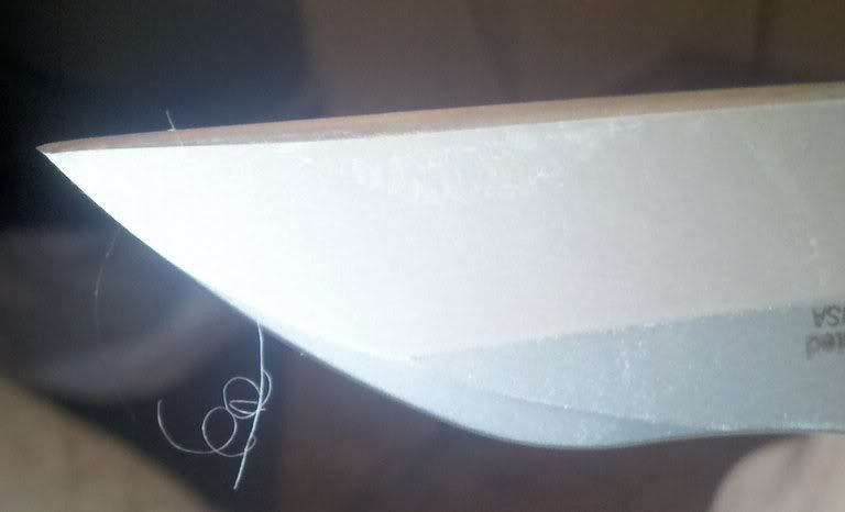

I started this thread to ask a simple question: Which indicates the sharper edge---ability to whittle a hair or ability to cut a hair in two?

There is so little that can be determined by playing with hair, mostly beacuse the attack angle determines how well it will cut. Essentially, there is technique to this as well as the knife being sharp, so it's really far from an objective test in the least. You can spend all day doing HHTs, to whittling hairs, to trying to whittle strands off the strands you just whittled, it doesn't mean anything about your edge except that it's sharp enough to handle ANYTHING else you throw at it. In the meantime, it can be so tricky to actually get the hair in the right position to cut that it can often times be more a matter of technique than anything else. It's a parlor trick. And I'm not even mentioning the differences in hardness, thickness, moisture content, curly or straight, so on and so forth.

Oh, and uhh, the obligatory proof
You can even see it hanging onto the edge by one of the strands whittled...
But even that picture is meaningless to me. You know why? Because when I first heard of hair whittling, I use to stretch a hair out between two fingers so it was taught and do it. I thought "Hey that's hair whittling." It takes a lot more refining to hold a hair out unsupported to do it. But you know how much discernable difference in sharpness there is between those two levels in actual use? None, none at all.

Thanks, gents, for your comments. Yes, when it comes to cutting or whittling hair, there are so many variables that it is a poor choice for any sort of objective test. But for me, at this moment, it’s this: as I began this sharpening journey, for a long time I couldn’t do it, and now I can (sometimes, with some knives). So, it’s a small personal milestone, and it’s fun to play around with. No more, no less….
Andrew
P.S.: Apologies for the crummy photo. My wife is out of town for her dad's 85th birthday (which explains why a grown man is spending time on a Saturday afternoon doing something silly like whittling hair!) and she took my camera to record the festivities. So, my only option was to make an attempt on my scanner.
