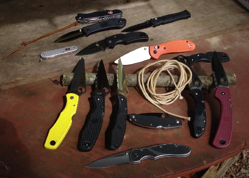

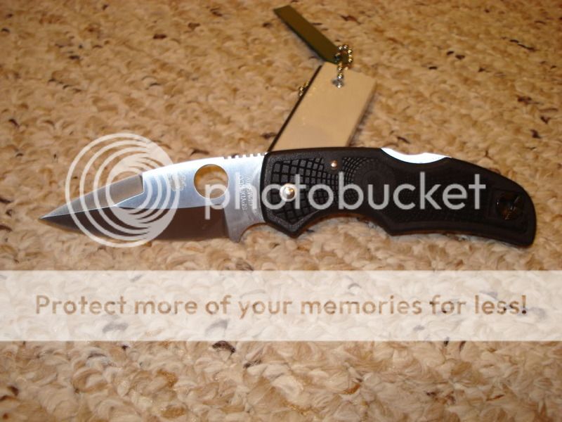

This is a picture of the knives tested. Except I had forgotten the mini grip and the Salt 1 was in my pocket.

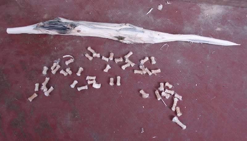

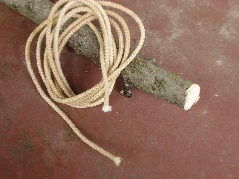

This is the stick and rope before I started. The stick is approximately 1" thick and 14" long. I'm not sure what kind of wood it is.

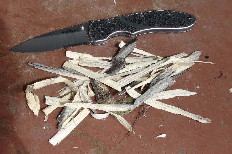

The Kershaw may have been the best of all of them. It cut very well with either the serrated portion or plain portion of the blade. The knife weighs right at 4oz and feels very solid and comfortable in the hand. The edge digs into the wood and cuts even strips with minimum effort. It was still razor sharp and popped cut the cord afterwards. Unlike some of the other knives in the test I didn't do pull cuts with it, only push cuts, but based upon how it feels in the hand I think it would do well with pull cuts. At about $35 this Wal-Mart exclusive is a pretty darn good knife.

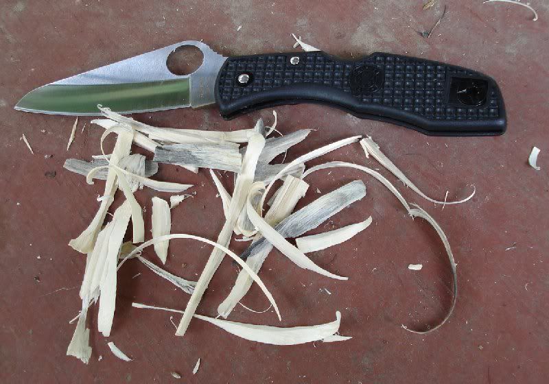

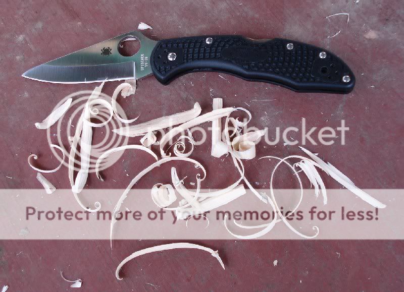

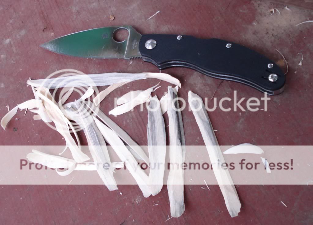

Another really good knife was the Spyderco Caly 3. It's thin, full-flat-grind blade easily cut long even pieces of wood with little effort. It did well in both push and pull cutting. It was very comfortable in the hand and was easy to control. It popped rope and shaved afterwards and showed absolutely no signs of edge loss.

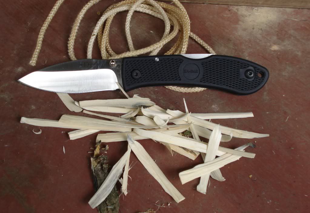

Ka-Bar Dozier: Another very good knife I got for around $22. comfortable, strong, solid, and with a high hollow grind and a lot of belly. This knife can easily turn a big stick into a pile of shavings in no time with little effort. The Aus-8 blade was still razor sharp at the end of the test. I'm very impressed with this economical knife.

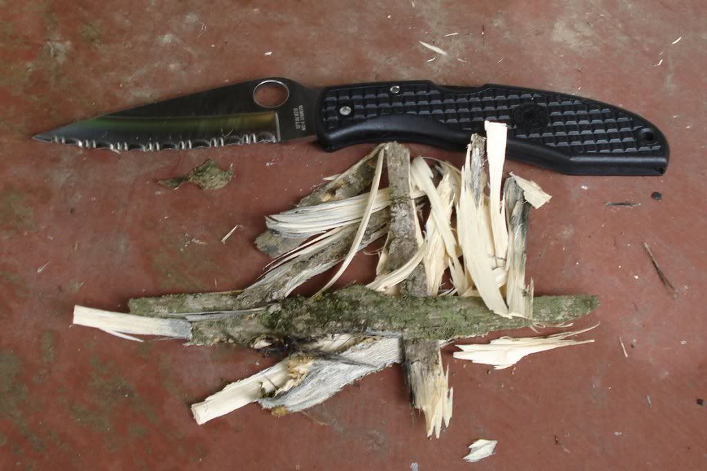

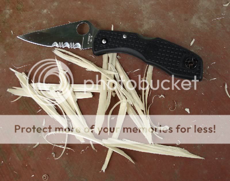

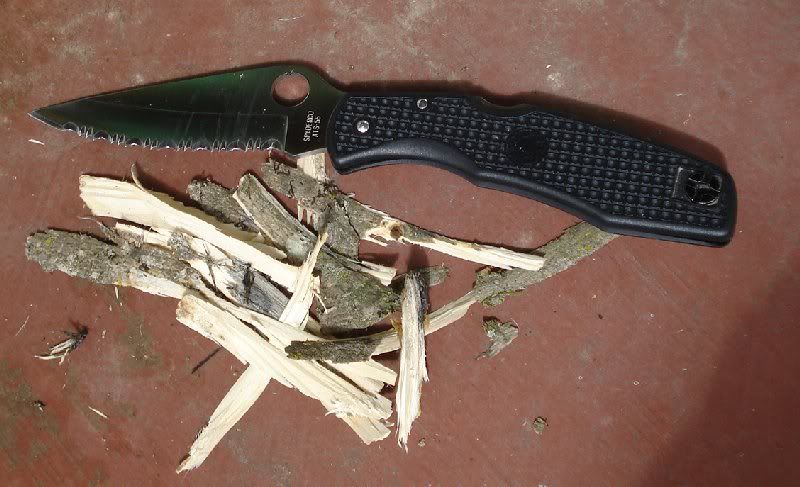

Spyderco Wayne Goddard: Bigger than the others, with a VG-10 partly serrated edge. It's handle shape makes it very comfortable for normal push cutting but It's not so good for pull cuts. The serrated portion of the blade cut smoothly into the wood like it was butter and produced clean strips. The plain edge portion also cut well but produced smaller shavings. No problems with edge retention. A good choice for someone going camping.

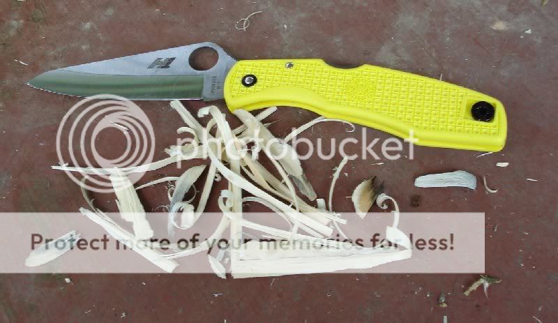

Spyderco Salt 1: The last of the 'really good' cutters. This knife surprised me. The Delica 3 style FRN handle was comfortable and the hollow ground H1 steel blade cut as well as any of the other knives in this test. The Salt 1 actually cut with less effort than the Pacific Salt. Maybe because it is smaller and my hand had better leverage. H1 has a reputation of being soft but it was still able to pop rope and shave after the test. A great knife.
