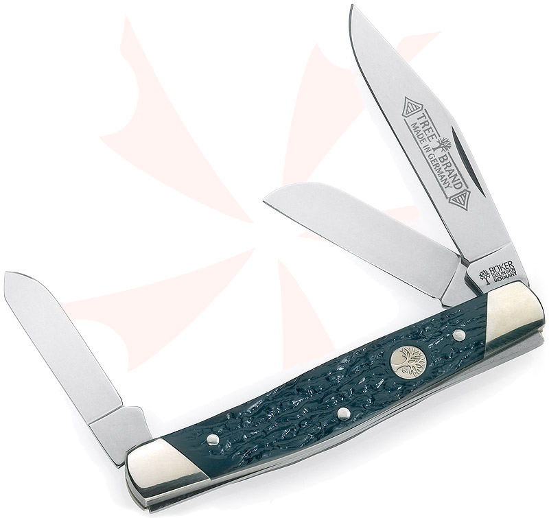

That's a nice knife that was designed for guys who really work outdoors all the time. My grandfather wore out a ton of them. He never asked where he could find a heavy duty knife for a crisis situation. I don't even know if he ever owned a sheath knife. If he needed to prepare game he brought a boning knife and a butcher knife to supplement his stockman.
