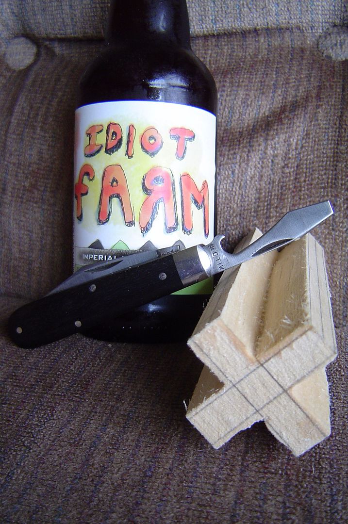

Recently, I was asked my GT (5K Qs) if I could post up a work-in-progress. Just to make sure everyone knows, I am no expert whittler. It is a way for me to use my knives, and I find it very creative and enjoyable. I have found, for me, that my Case coke-bottle makes a perfect little whittler (I don'y have any "true" whittler patern knives). I use a TC barlow for long straight cuts, and removing lots of wood. I use soft pine hobby wood blocks. So, here goes with a couple example projects.
The Three (or more) Link Chain

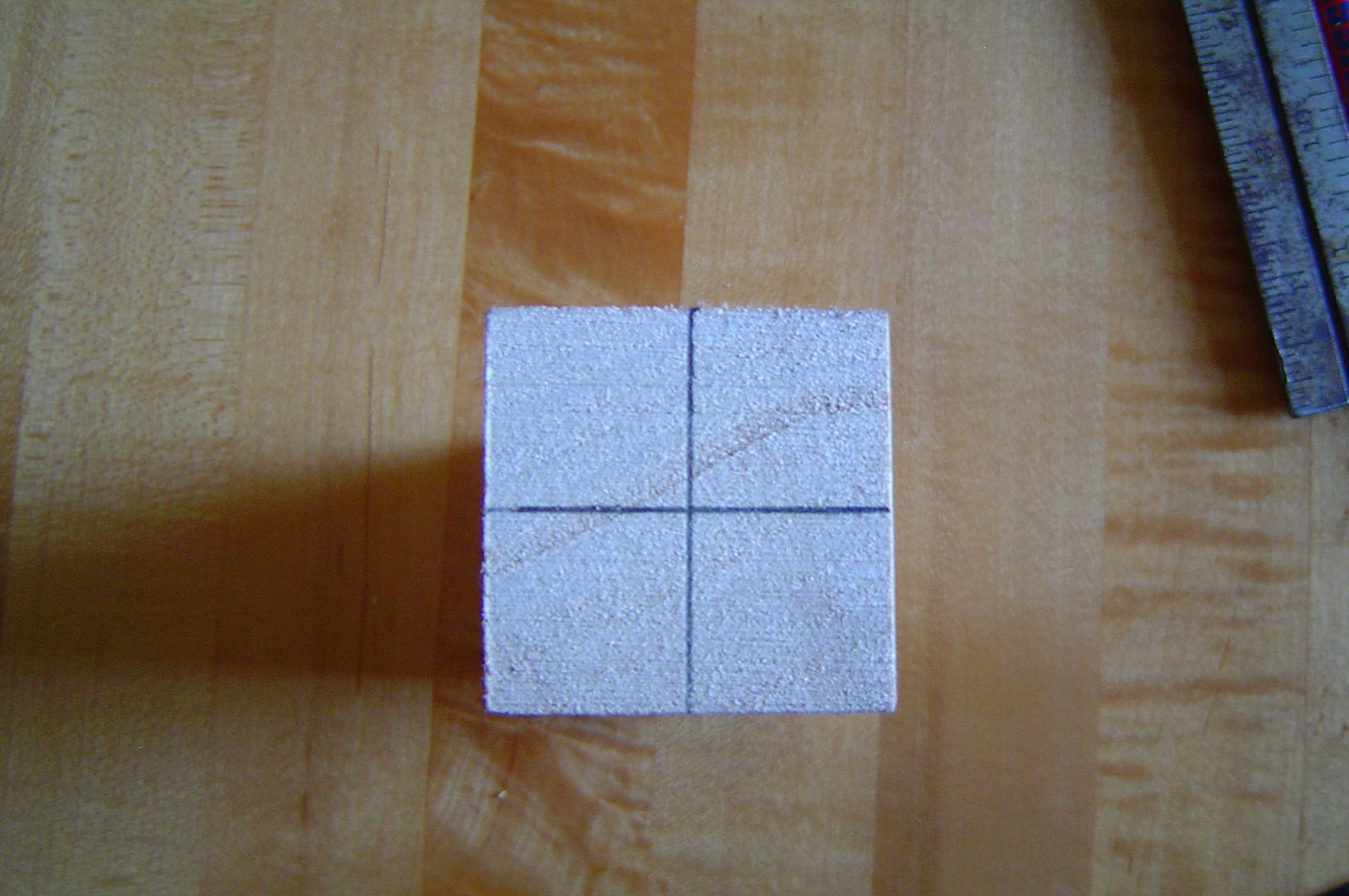

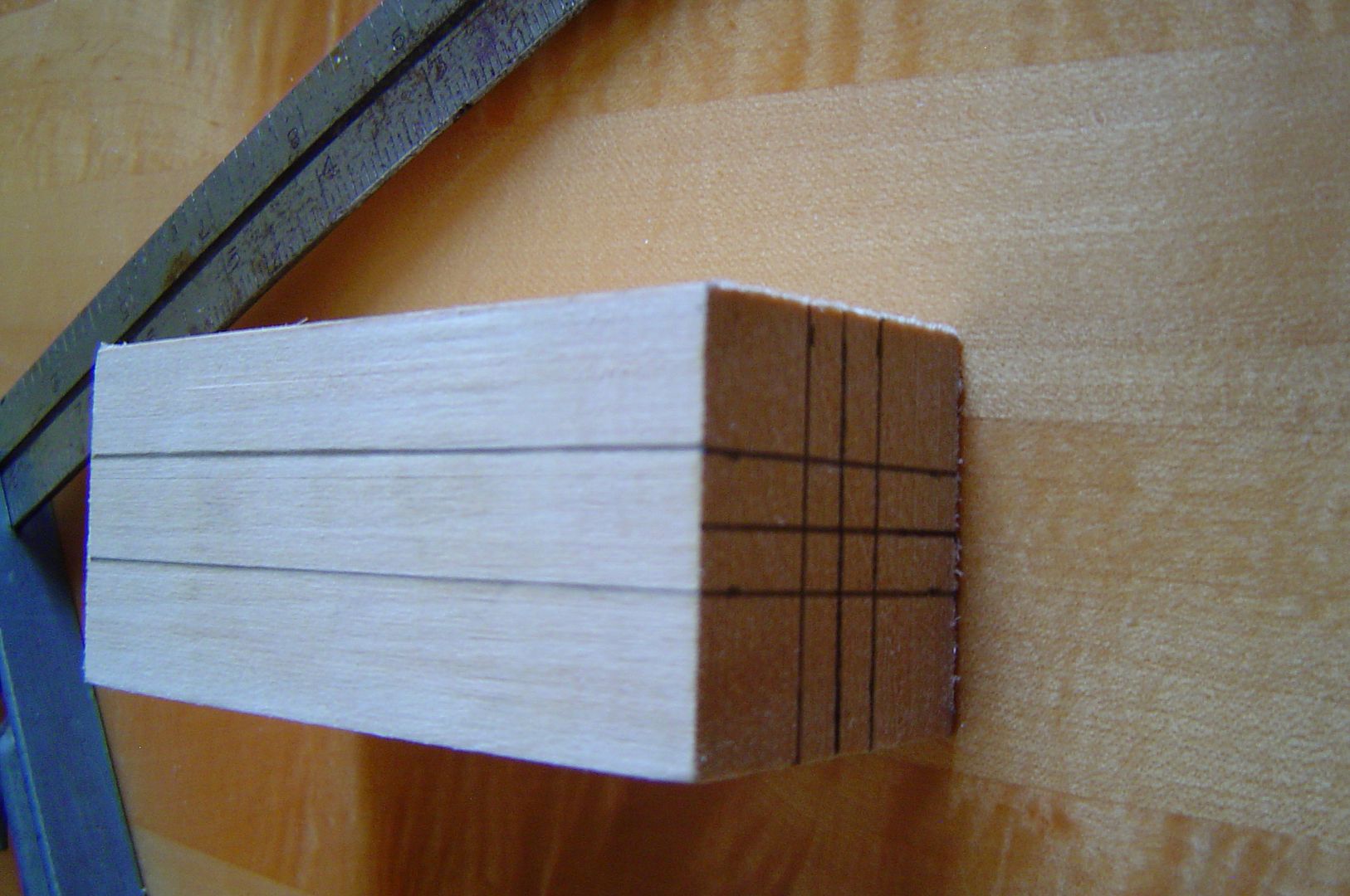

Laying out the design - the basic shape will be an extruded plus shape, or x. Looking at the end of the block (mine is 1.75" square, by 6" long), mark the center lines both ways.
Then decide how thick you want your chain to be (3/8" or 1/2") and mark off the ends. Then transfer the + pattern to all four sides of the block. If this doesn't make sense, it will when you see the chain links later.
Now remove all the wood except for the "extruded +". This shows me working on 1/4 of the wood needed to be removed.
This is what your block should now look like. You could use a table saw, band-saw, or hand saw to get to this point if you wanted. There is no shame in that, it's your project, you make the rules.
Another shot of the extruded + shape, after this much work, it's time to use that Radio Jack for something other than cutting wood!

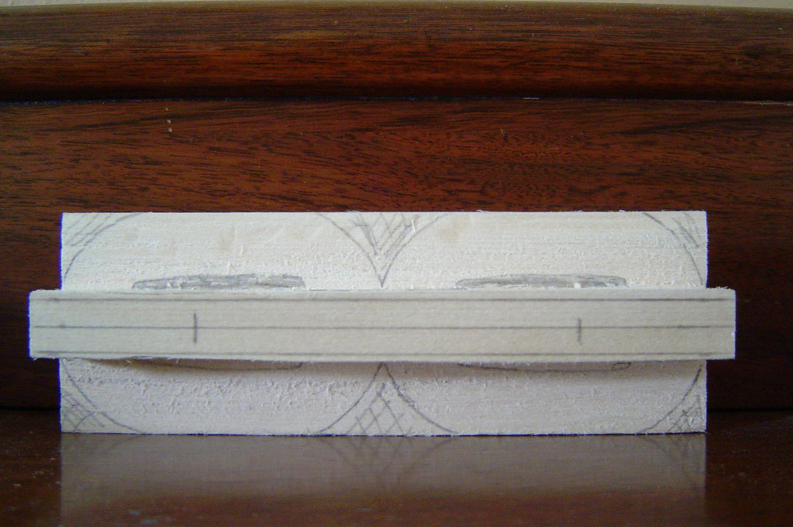

Now it's time to draw on the links of the chain. Two links will be in one plane, one link in the other. So, my links are about 3" long, 1 3/4" wide, and 3/8" thick. Sketch them on however you can. Make a paper pattern of 1/2 a link, cut it out, and trace it onto the block. This photo shows the two links, there is the middle link which you can't see in the horizontal plane.

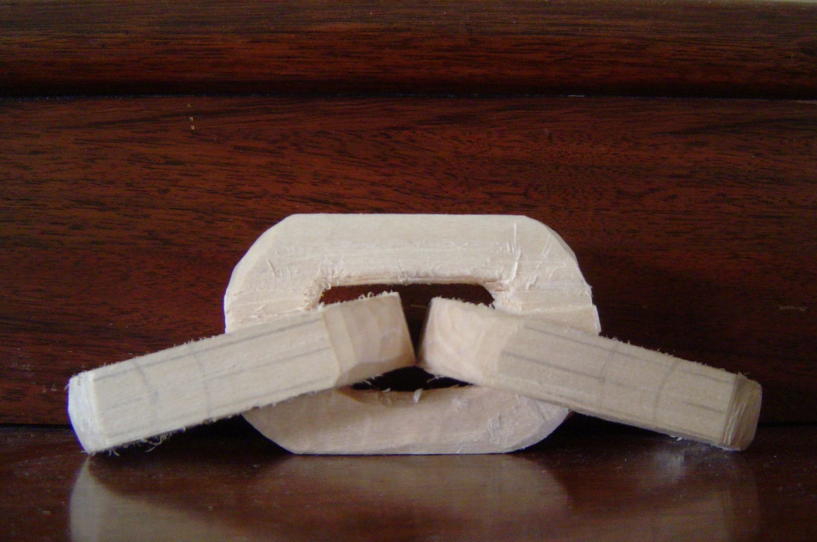

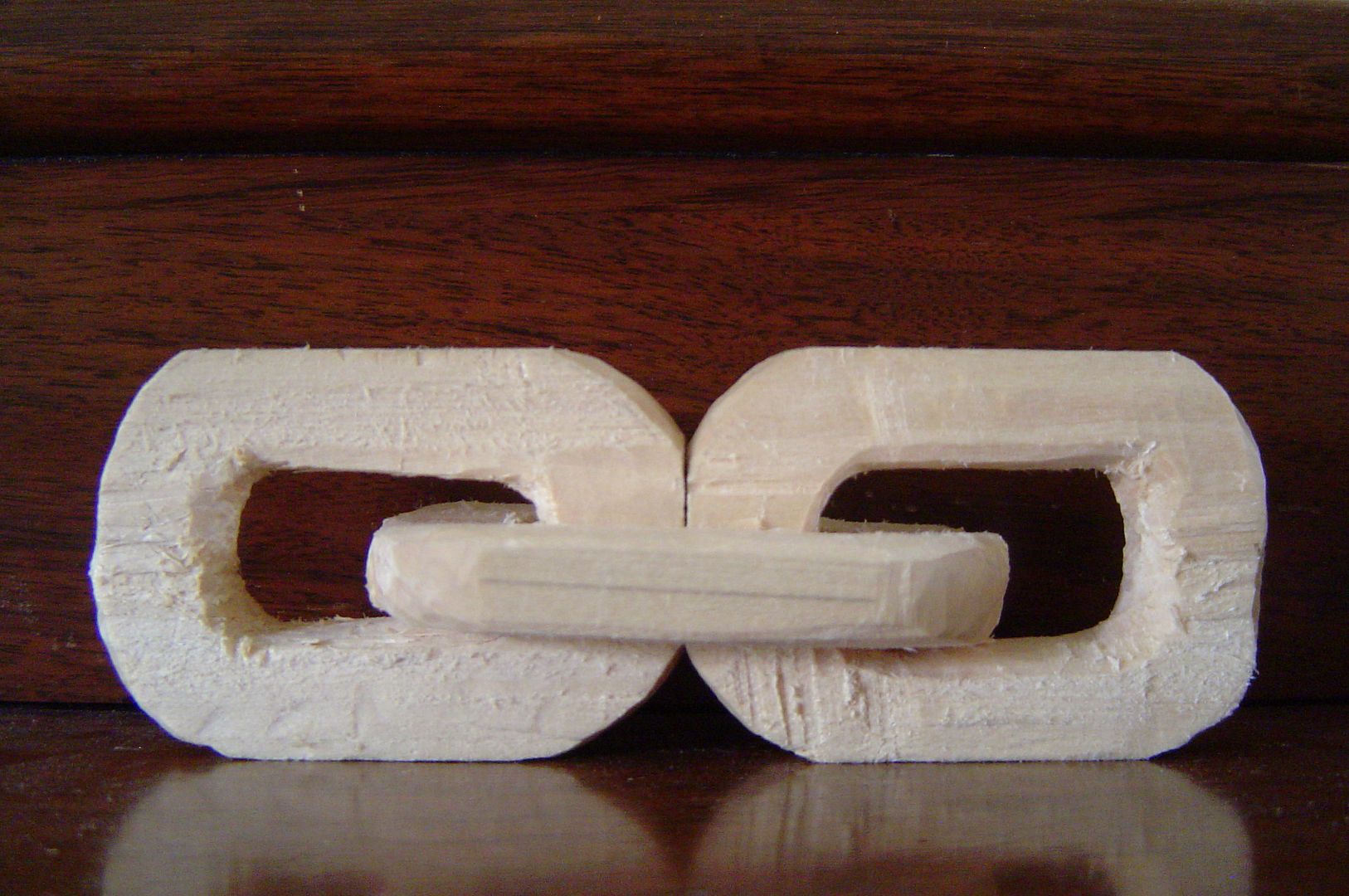

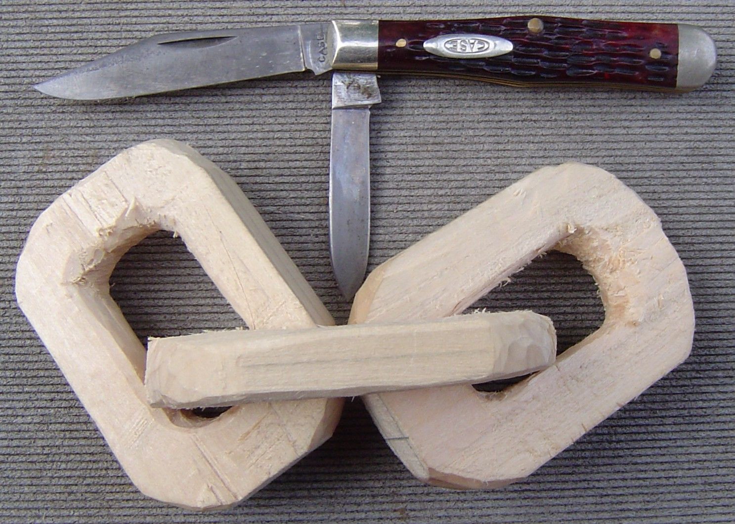

The shaded areas need to be cut out. This takes some time and patience. Cutting the two links apart from each other is pretty easy. Cutting the middle link apart from the two outer links is hard. You will need to gently break them apart.
Break like this:
Be careful, if it does not want to break apart, you need to cut more. If you force it, it would snap the link and you have to start over.
More in the next post.

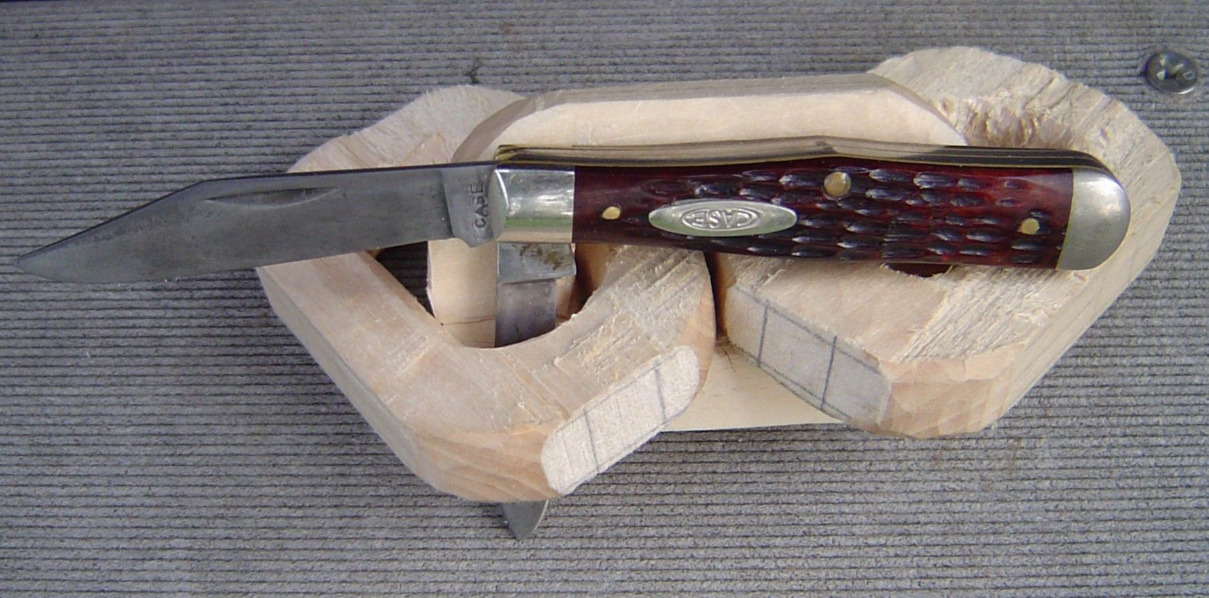

Here's the little workhorse that got me to this point, and will get me all the way home - Case red bone coke bottle. 3 1/4" (or 3 3/8" I forget) long, feels great in hand. And looks great in red bone to boot!

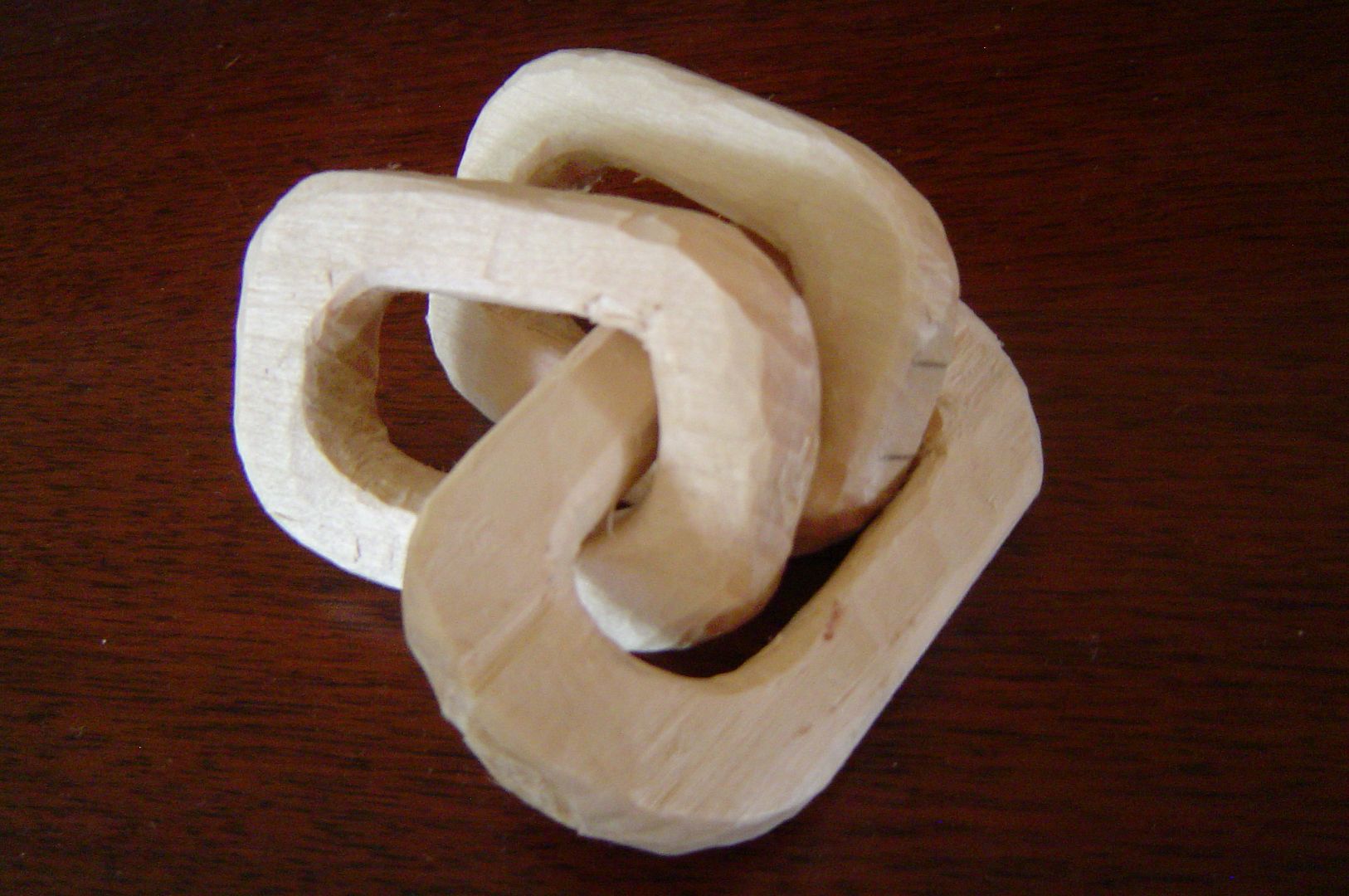

More shaving, starting to look like a chain. Watch the grain, don't cut too deep, take it slow and easy.

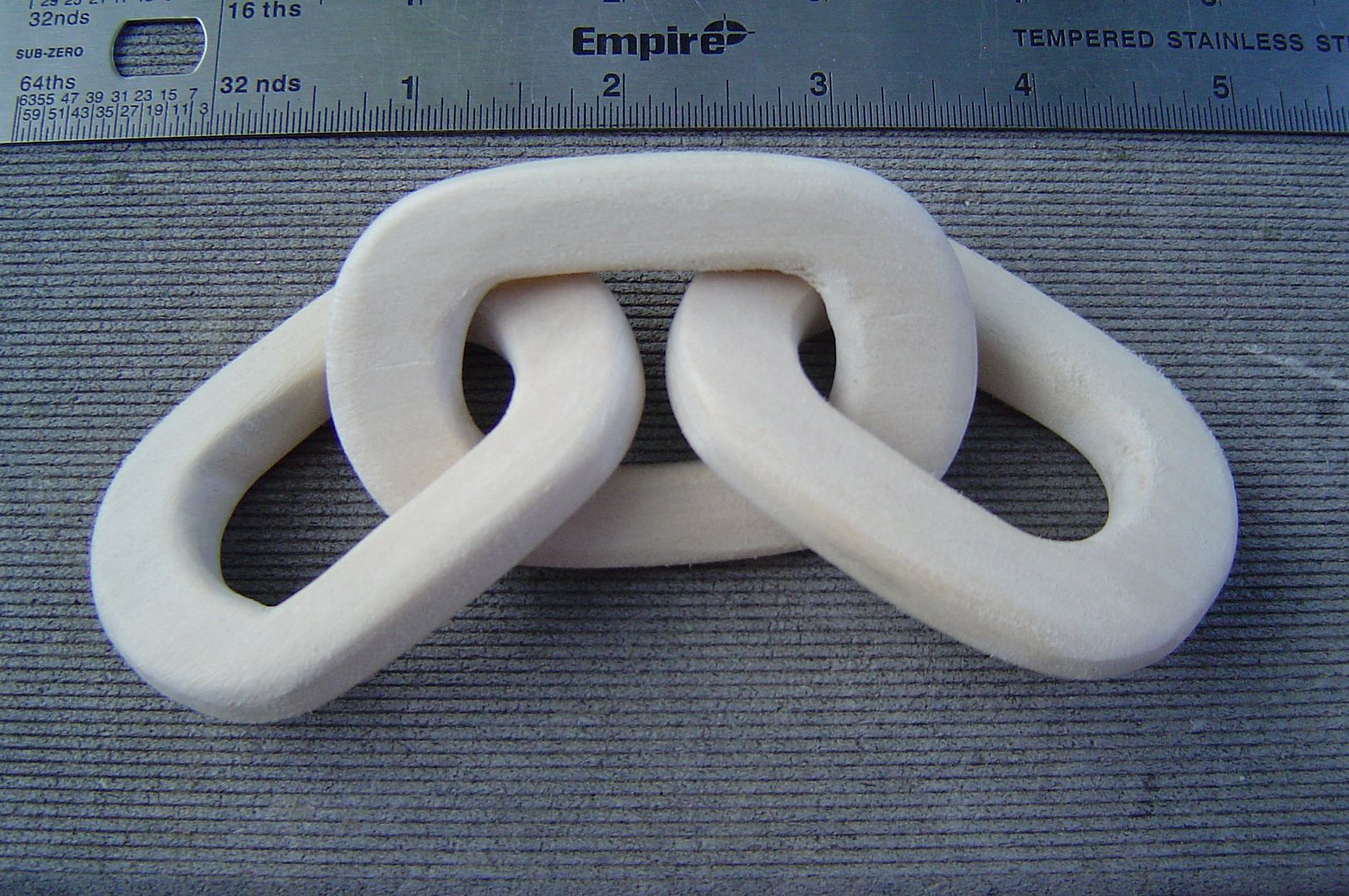

Get the sand paper out.

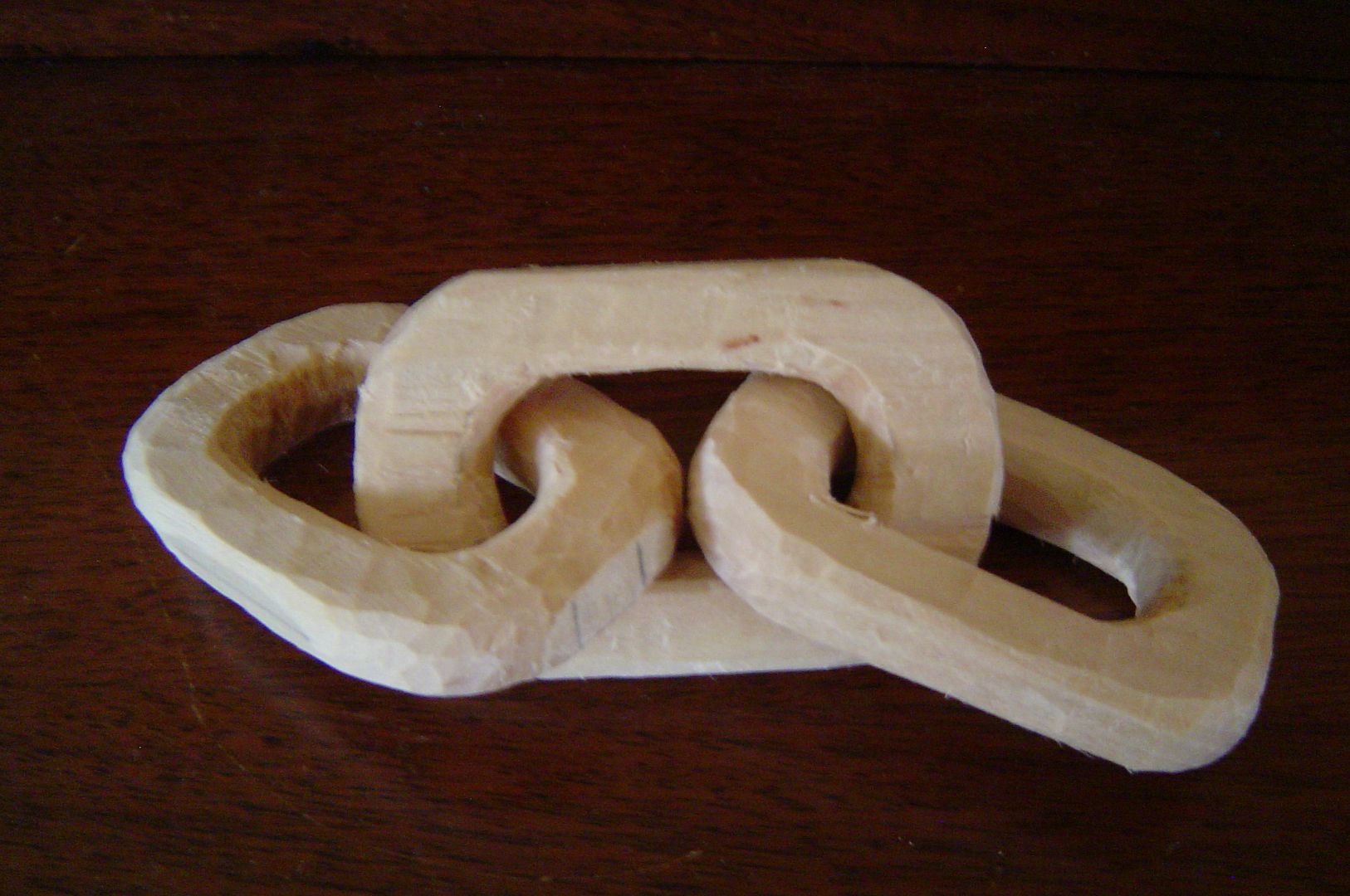

Ask the little kids how you put these links together!
Next time: Layout and carving of a mini ball in cage (or how to for any size ball in a cage). Post up your whittlin' please, I hope some expert/advanced guys show a how-to.
