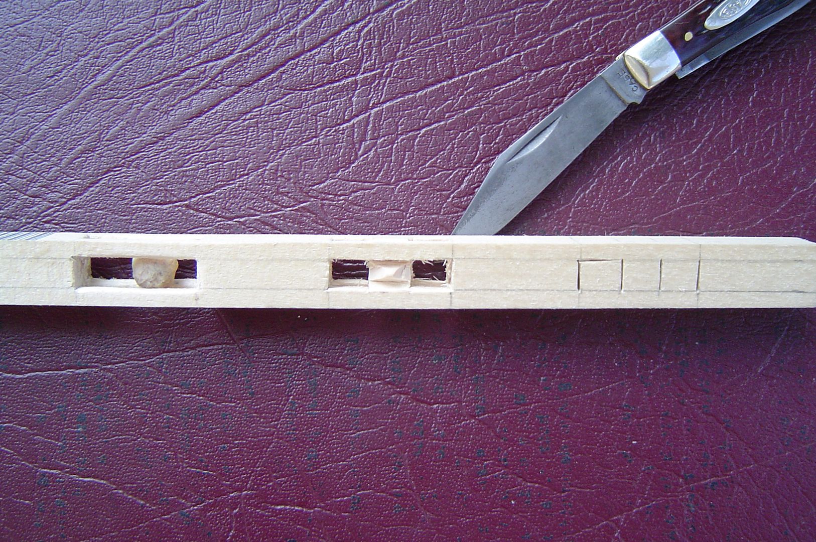

Next project: the classic Ball in Cage. This will be a little bit piecemeal, as I didn't take enough good photos the first time around. I will show how to lay out a block, and then I'll show how to whittle it on a smaller block. I suggest doing a larger block if it's your first.

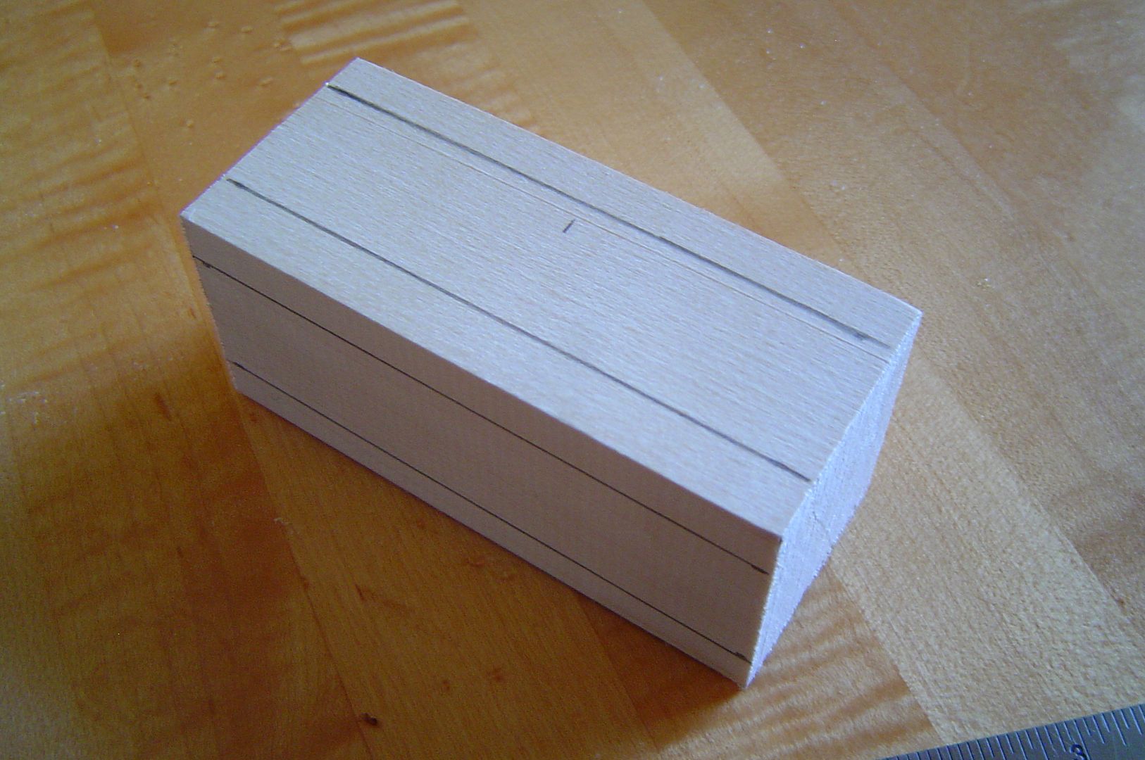

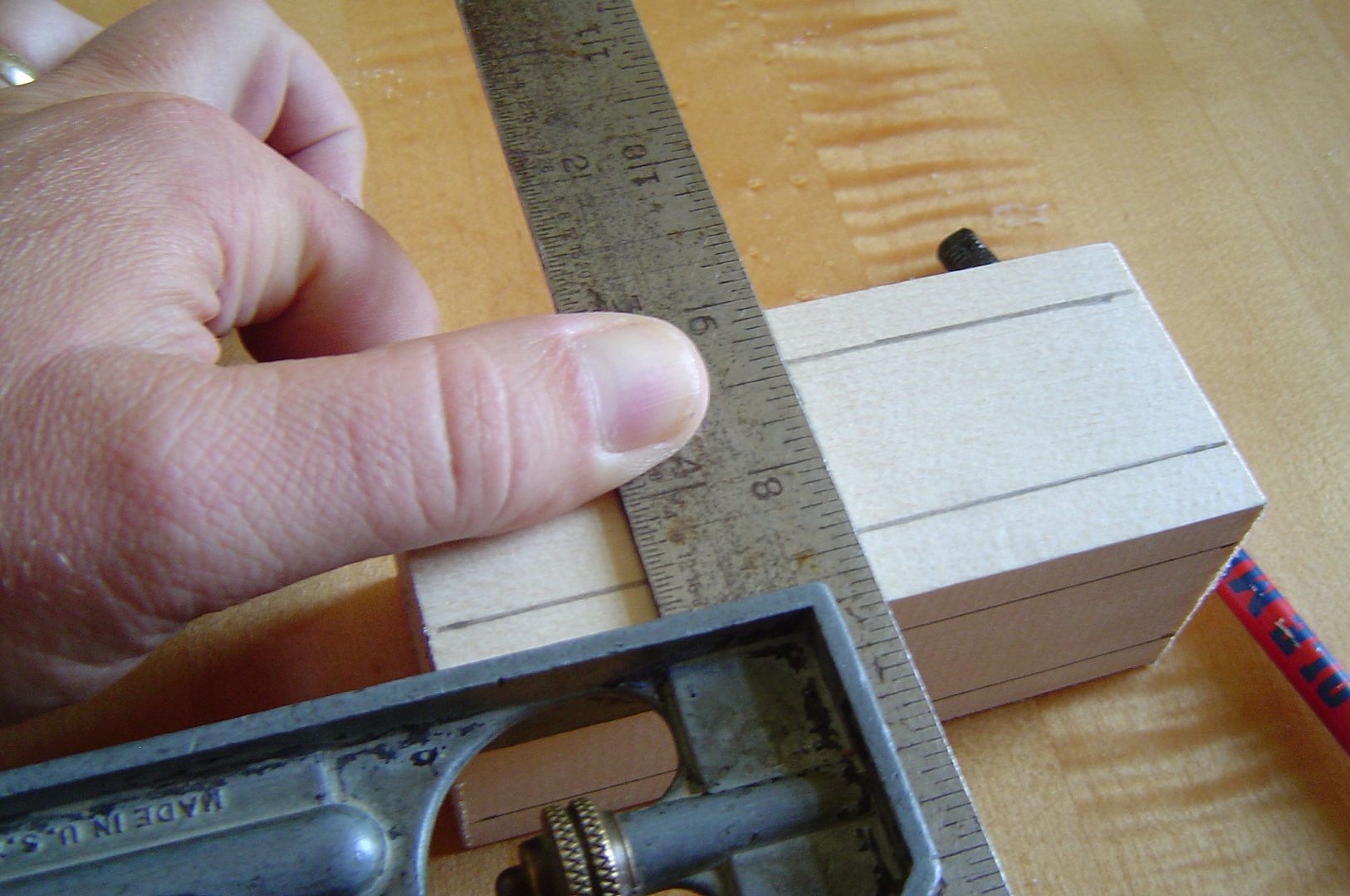

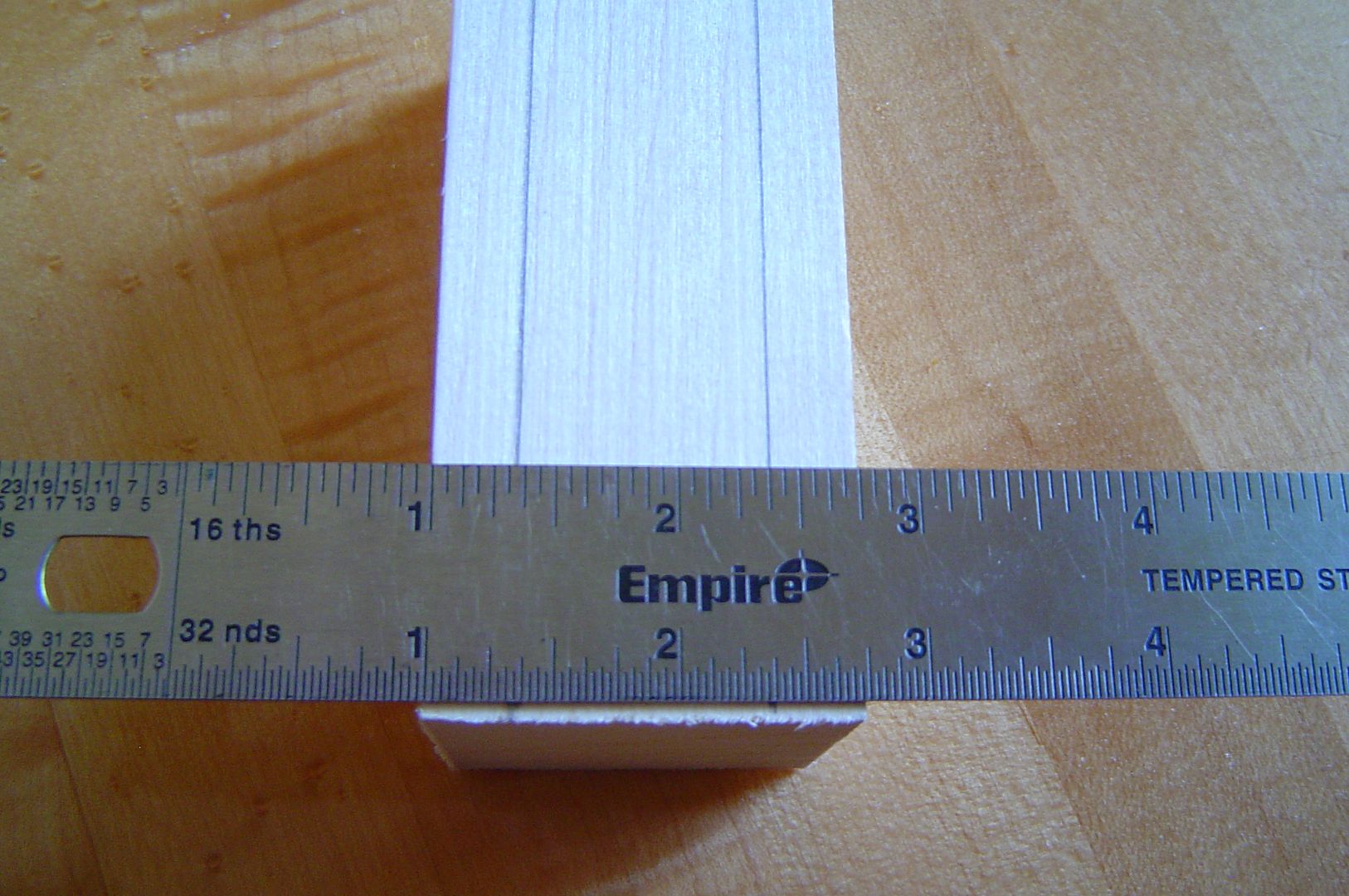

Get a block of wood, square cross section, maybe 1"-2" X 3"-5". Hobby store stuff, I used pine. Decide how big you want you rails to be, I used 3/8", draw in the lines on all sides of the block.

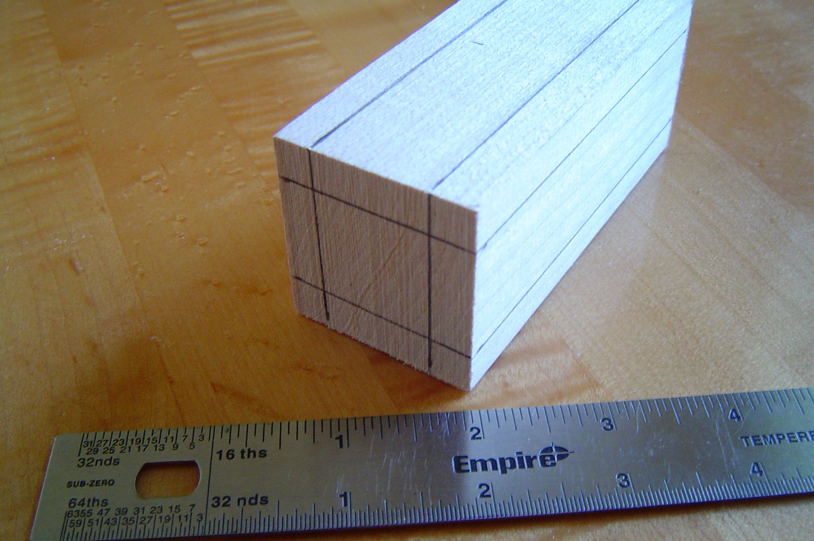

Transfer the lines to the ends of the block.
Measure the small diagonal. This tells you how large your ball needs to be (approximately). Call this measurement d. Write down what you get.

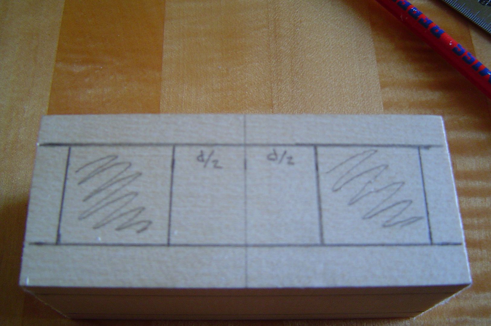

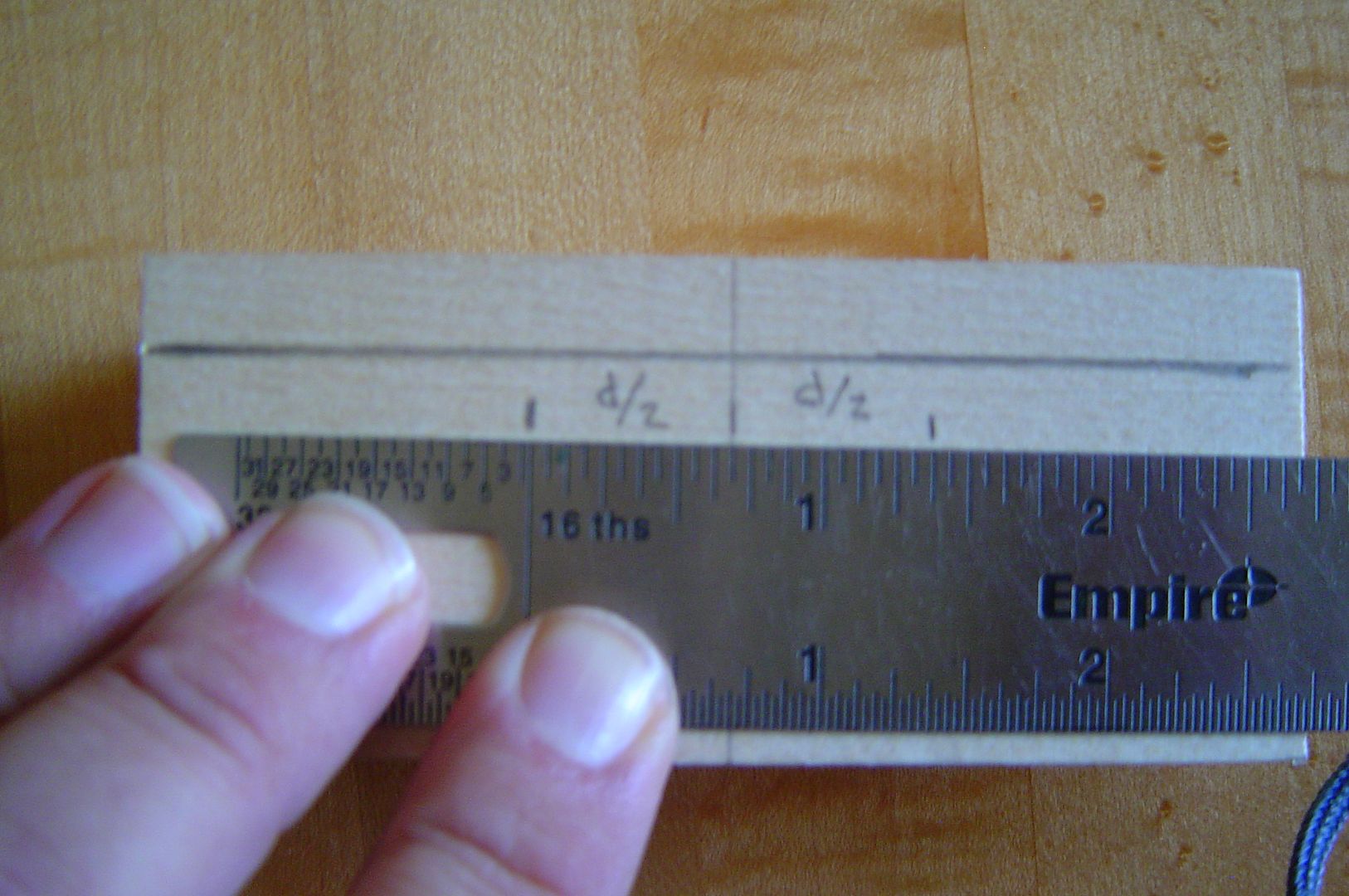

Mark the (lengthwise) centerline of the block.
Take the d measurement, and mark off d/2 from the center of the block.
Mark off the distance from each end (~the same as the rail width).
Do this on all four sides, the shaded area will be cut out completely, and the center area will form the ball.

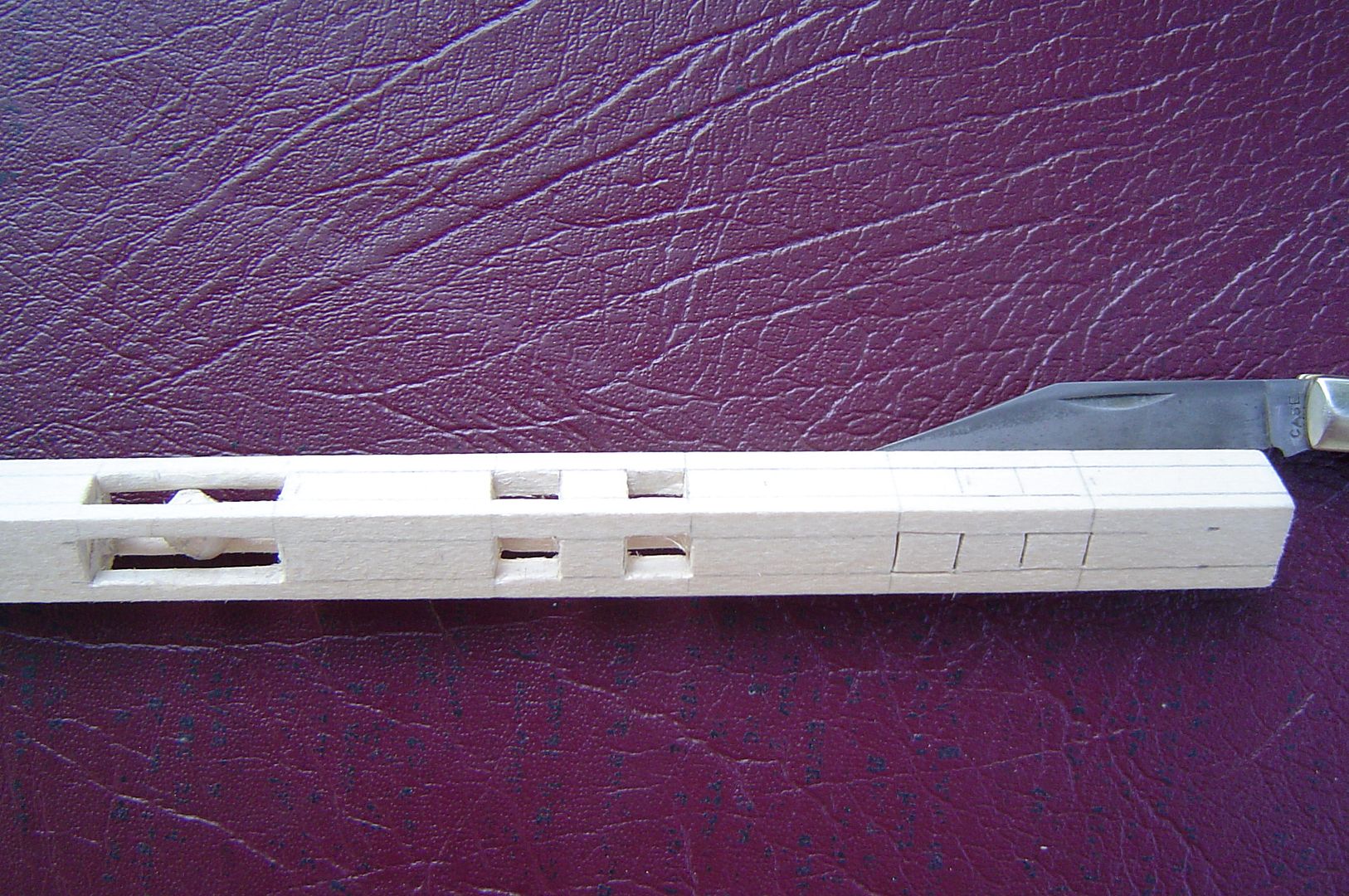

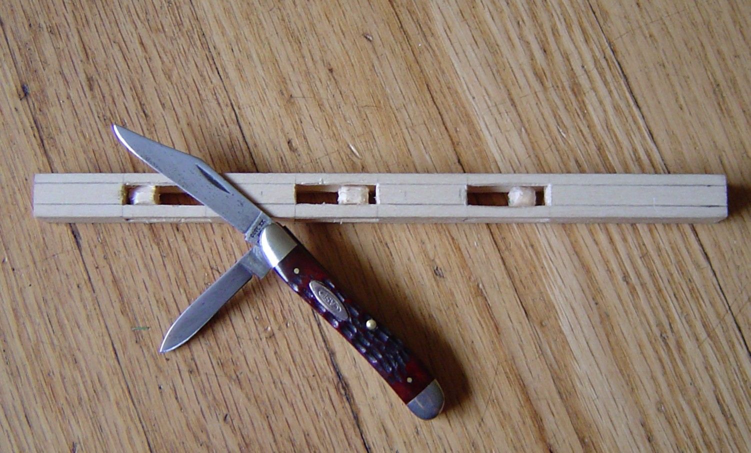

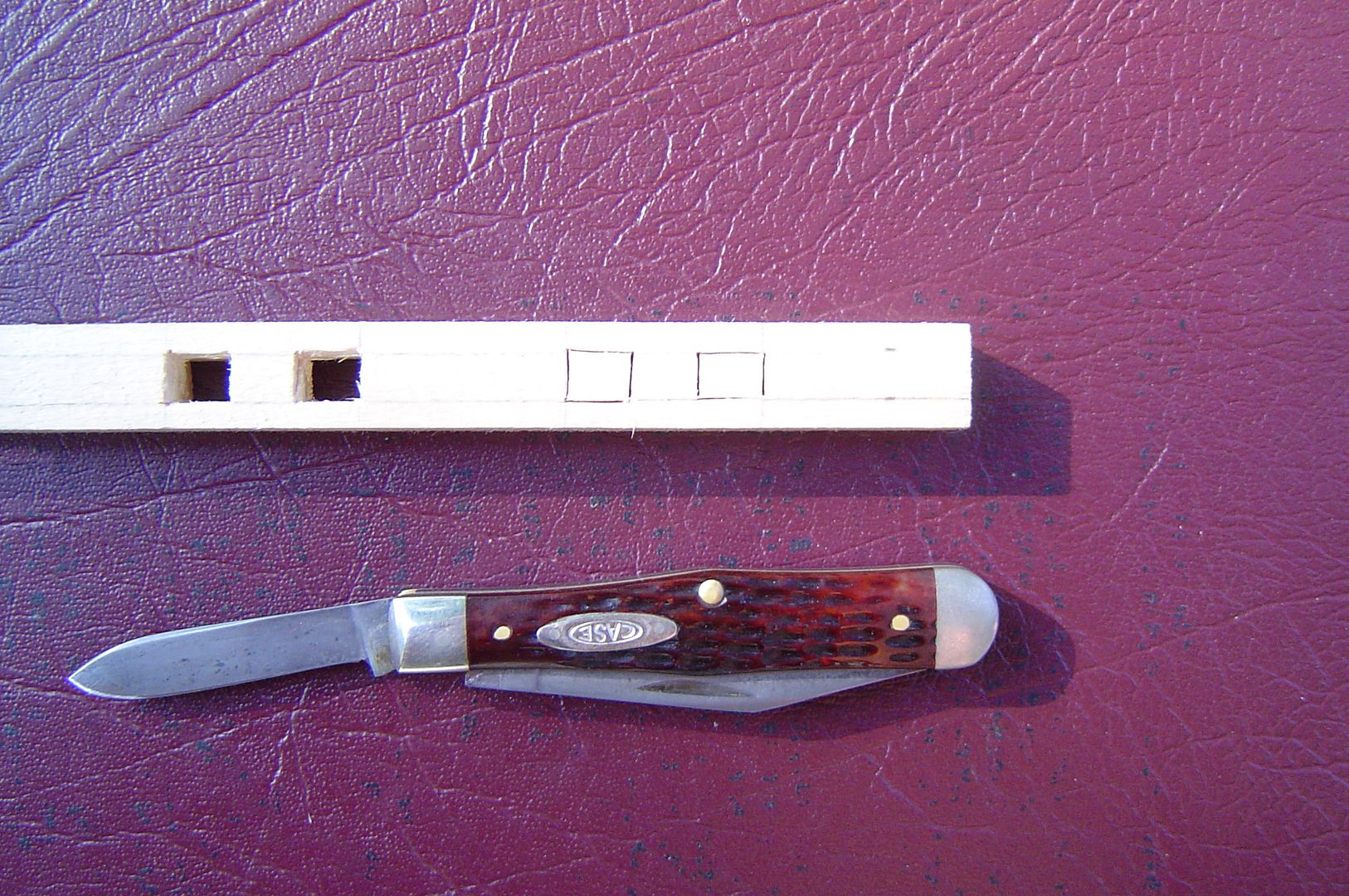

Now I'll use my mini to show whittling. This stick will end up having 3 balls and 3 cages. Make stop cuts along the area that is to be removed.
Once you have 4 full stop cuts, cut along the rails.
Start splitting out the wood. Do it for all sides and it looks like the left side of this photo.

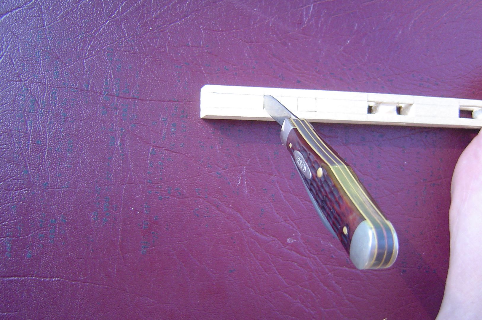

Start splitting out the ball (it will be a cylinder at first). These cuts are a little hard to articulate, see the pics.
Carefully cut between the rails and cut the cylinder loose, so it can slide. Start the long arduous task of rounding the ball!

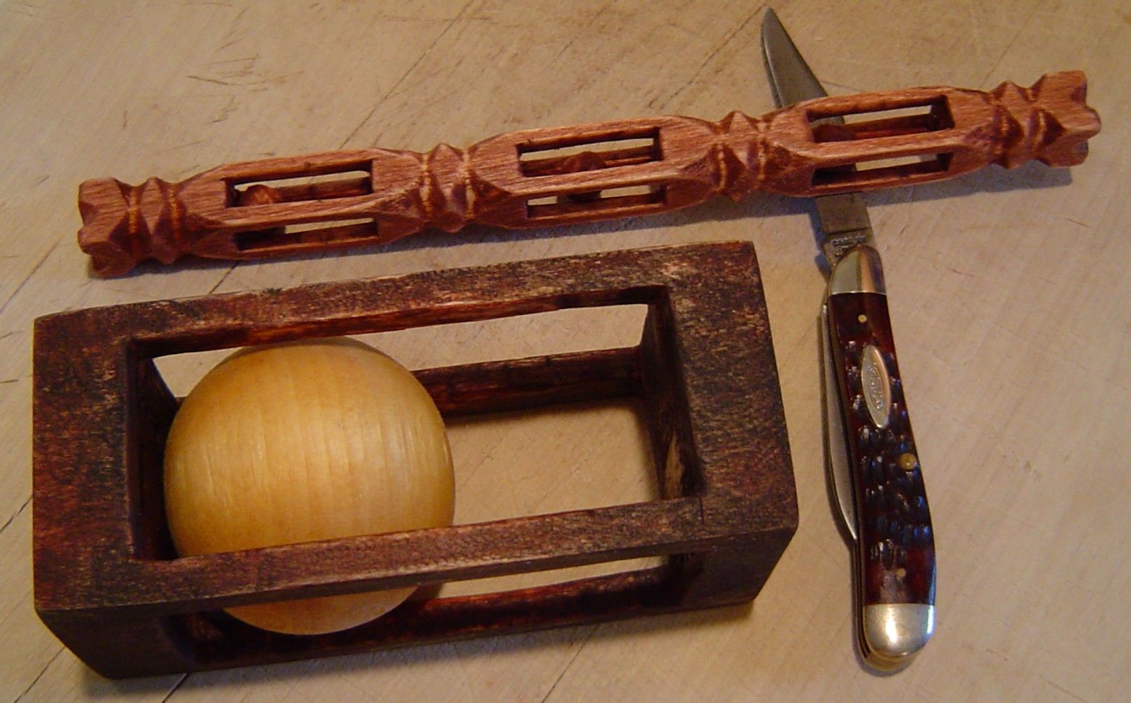

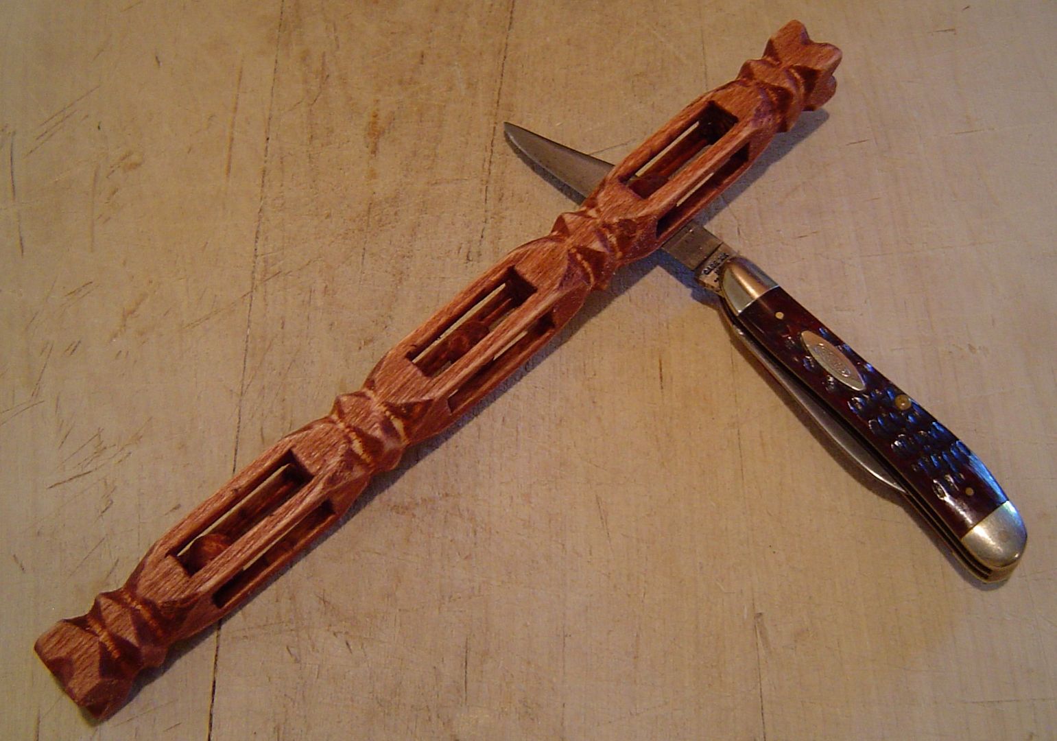

Here's mine all fished up, I added some embellishments between the cages, and stained it.
My two ball/cage projects together. I used a Case peanut and a Case cokebottle jack for all the detailed whittling.
