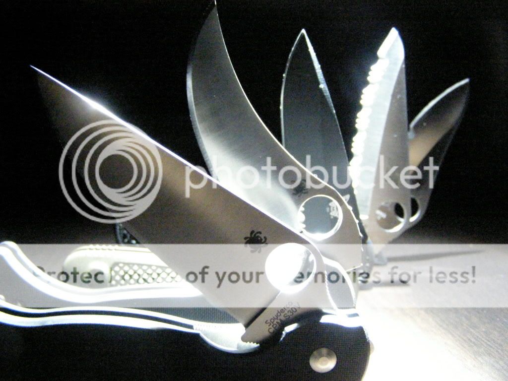

I like to go perpendicular to the edge. Here's a photo of a Kershaw Junkyard Dog II which I shortened the blade and took down the spine a bit, then did with 4/0 emery cloth:
The Dog looks very nice.

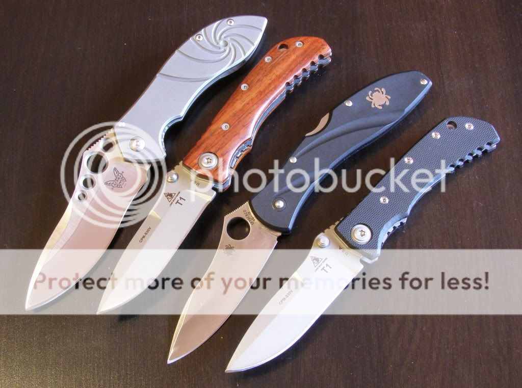

Perpendicular is the way to go, after more than one hour work on the Skirmish's blade it looks much better.
Thanks for your help.
Here is Skirmish with other small knives, the G10 T1 is my wife's ;)

Glad to hear it worked out well! :thumbup::thumbup: Nice looking collection you've got going there, BTW.
