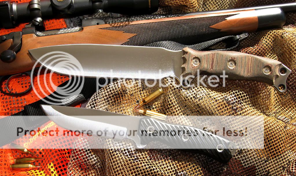

Here are two of Norcalblacktail’s full satin jobs. Both knives started as regular cc coated blades. Nate does really beautiful work. Thanks again Nate! Sorry about the dust.
