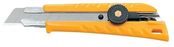

If I spent the whole day cutting cardboard, then maybe I'd be into super steels. Or utility knives :D
