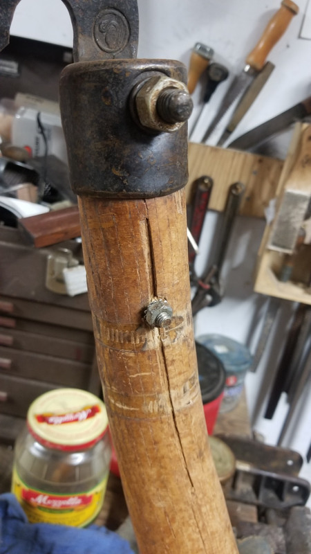

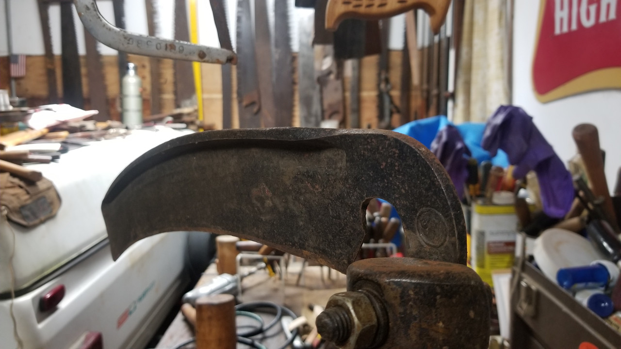

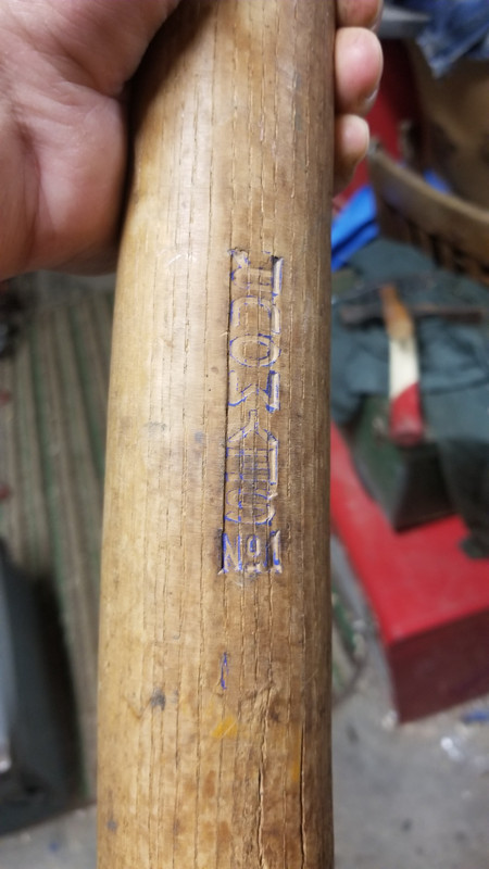

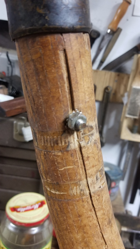

Looks like the blade is an older Redtenbacher. You find the round logo on older examples. They switched to an oval tang stamp on later ones. If I'm not mistaken it looks like the lower nib is positioned on a section of snath that's oval in cross section rather than round like it ought to be? I think your snath was probably made in the late 70's or so. They were still using the blue-painted stamped branding/model number at that point, up through the 80's I believe, but the quality of the post-bending truing-up went to crap and a lot of them are seriously out of round from the removal of cracks and delaminations suffered during the bending stage.

Perhaps depending on the age of the blade, the snath is a replacement for it...and due to the exact issues you pointed out, the snath inherently gave the user trouble?
The snath at the nib if not both nibs is not round and now I better understand why they are tweaked, deformed, not tight but loose fitting to the snath yet now ultimately tightened so much and so hard...frozen solid after they put the scythe aside for the last time.
Thank you for the information on the snath and its poor symmetry allowing for the improper fit and inadequate adjustments, if even they were possible, to the nibs.
I will not be worrying so much about the possible crack...I dont think I can add wood to the oval portions but perhaps I can work the nibs onto an area of the snath I make round yet still allows for comfort.

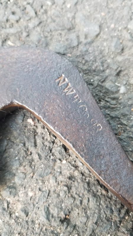

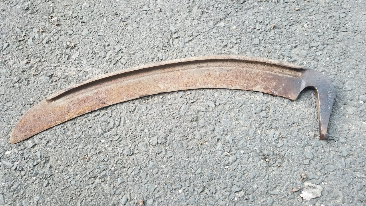

Just a little follow up and clarification...
Dunn Edge Tool Co.
West Waterville ME.
"The town started as part of Waterville, breaking away and becoming the town of West Waterville in 1873. In 1883, the town was renamed Oakland."
https://www.bnctools.com/blogs/news/axe-making-in-oakland-maine-part-1
Certainly appears old enough. The way that the knob of the tang is forged such that its sides are flush with those of the tang itself, along with the typeface of the tang stamp are good indicators.
