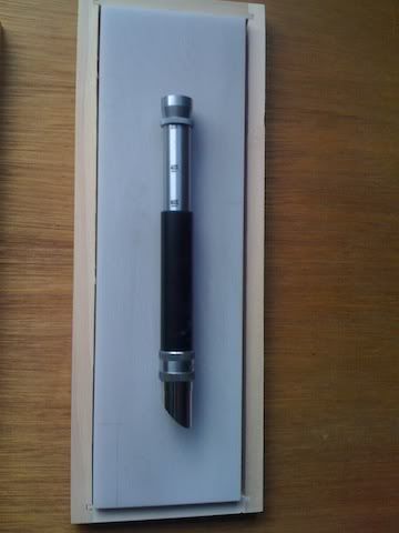

Oh and I have one of these hand held microscopes. It is pretty tedious to use but gives a very steady clear image once in position and is fairly inexspensive. It was my first mag device.
