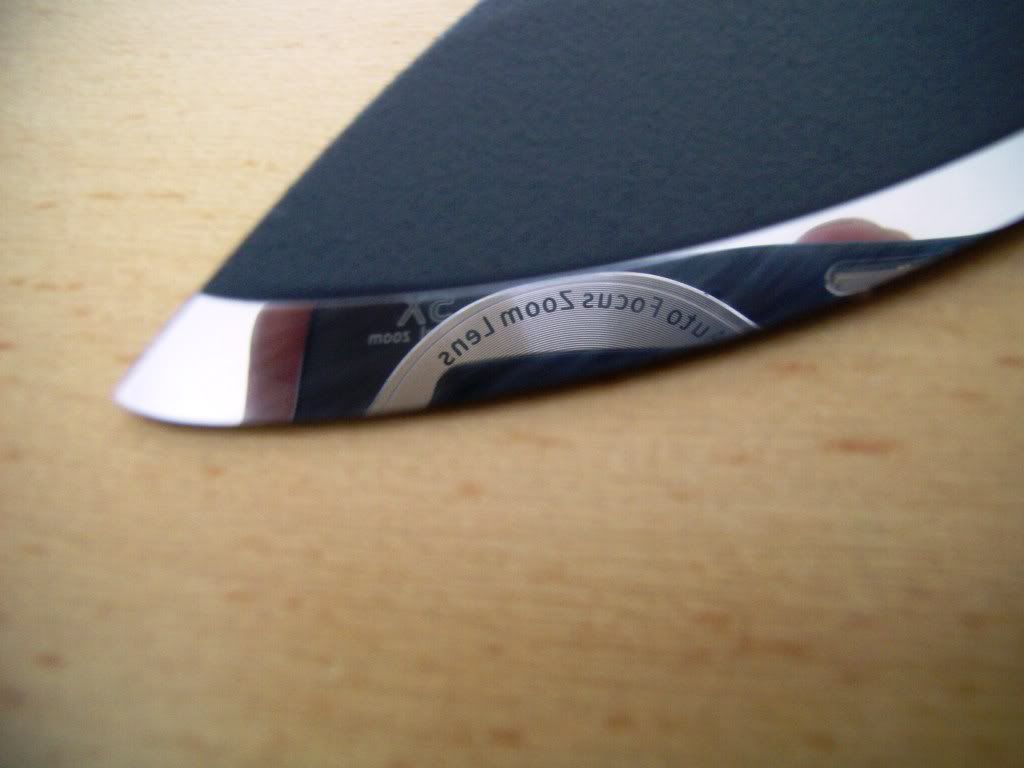

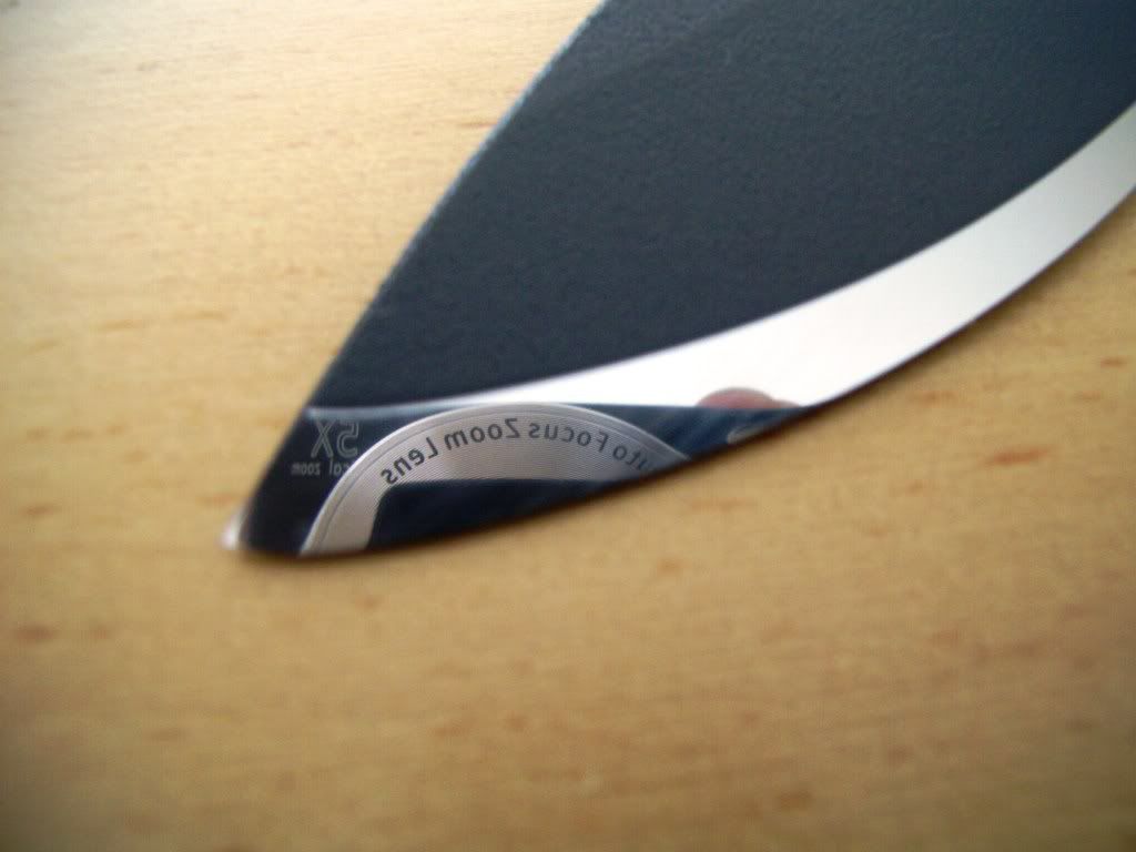

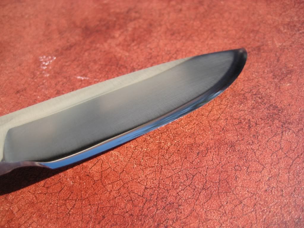

Borrowed pics - Not convex, but GORGEOUS mirrored edges on SR-101 S5CG (and great pics too!):
DWRW does beautiful work as does norcalblacktail:
Don't forget BAN. :thumbup:
I assume that pick is Norcalblacktail's work. :thumbup:
DWRW can "get" decent results, but still a hack-home-modifier compared to Ban and Norcalblacktail. :eek:

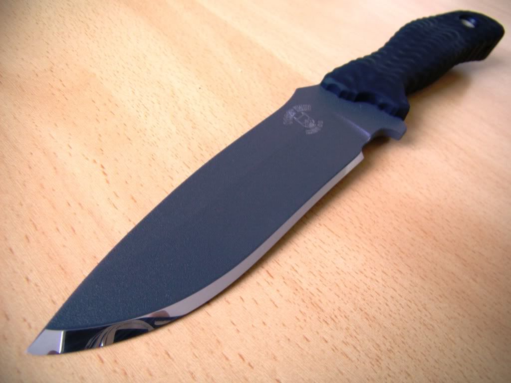

Yes, that's Nate's (Norcalblacktail's) work. And before I sent it to him, I asked Ban if he would be interested in stripping and convexing my RMD. Ban didn't respond, so I sent it to Nate instead. And obviously, I have NO REGRETS! :thumbup: :D
