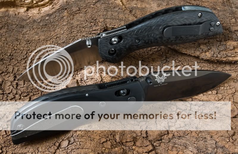

I have Wilkins on my M4 Ritter Grip and I love them but I also have another M4 Ritter that I had Dobson make scales for and those scales are the bomb as well
(pic by Phillip Dobson of my knife)
