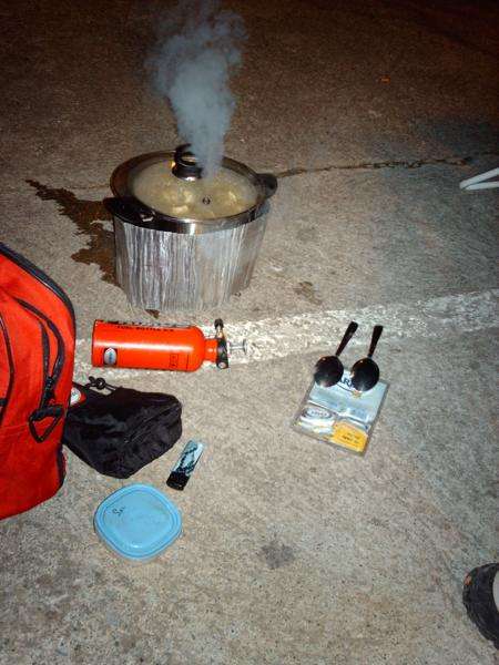

Whenever I plan to cook for a few days or be melting lots of snow... Primus Omnifuel is my choice. It is pretty much the same as a Multyfuel with the addition of another valvule. I have almost the same flame controll as the lpg stoves... so I can simmer. I tried a Multifuel once and it is a blowtorch... don't attemp to do any cooking with it. Gas is cheaper than butane/propane mixtures and they work great with low temps and altitude. The downside of using auto gas instead of white gas is that anytime when I come back home I have to dissasemble it and clean it. The same steel brushes used for spark plugs are handy.

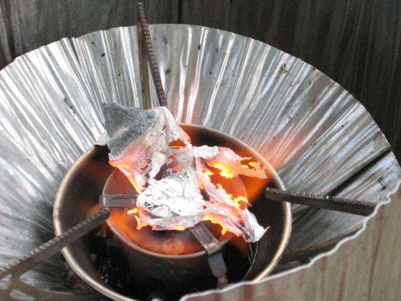

Some of my pictures (don't have any without the windshield... soooooorry...)

Blazink, there is a lot said about LPG and low temps... and I don't want anyone to burst in flames so read this carefully.
As long as your stove has a generator tube or some kind of vaporizing gizmo on it (all the multyfuel stoves have them, that is exactly why you can burn gas, diesel and querosene with them) you can use your LPG canisters UPSIDE DOWN. The idea is that the vaporised propane that stays on tops pushes down the liquid. Once the liquid LPG reaches the vaporizer-whatever it... vaporizes... and burns cleanly. Coleman Max works that way but the fuel is expensive. There are some other stoves that work the same way but let you use almost any kind of canisters.
Just a tip: If you ever need to light a stove below freezing temps and the canister doesn't want to wake up... put it a little bit inside your coat or pee on it (yeah... I know...). That should do the trick and warm it enough for lighting it. But be aware that as soon as you start cooking with it... it will cool itself due to the vaporizing LPG inside so you have to prevent it from freezing off again. If you have some water and a plate... put the canister on the plate and fill it with water. The water has a high specific heat (I am translating from Spanish, so chances are I am not using the proper terms...) so the cold from the canister won't be able to freeze it (at least for a while). The water will keep the base of the canister at 0ºC... and that is enough for the butane to vaporize. If you don't keep it semi-warm this way or another... you will end up burning just propane... and when you run out of it... you will have a canister half full of useless butane.
