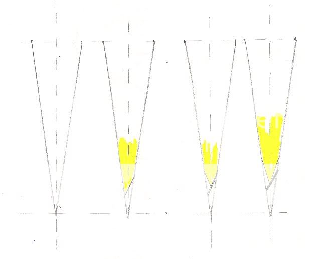

That is a sabre (V) grind with an asymetrical edge.
left one is the unsharpened blade
next one is after Emerson sharpened it
next one is if you even it out the minimum - much larger edge angle = harder force required to cut
right one is if you try to get equal edge angles at approx the same angle as Emerson got - have to sharpen both sides to get this.
I'm sure Richard would have done this anyway, just wanted to put pics to the conversation, they often are the best way to figure out what's going on.

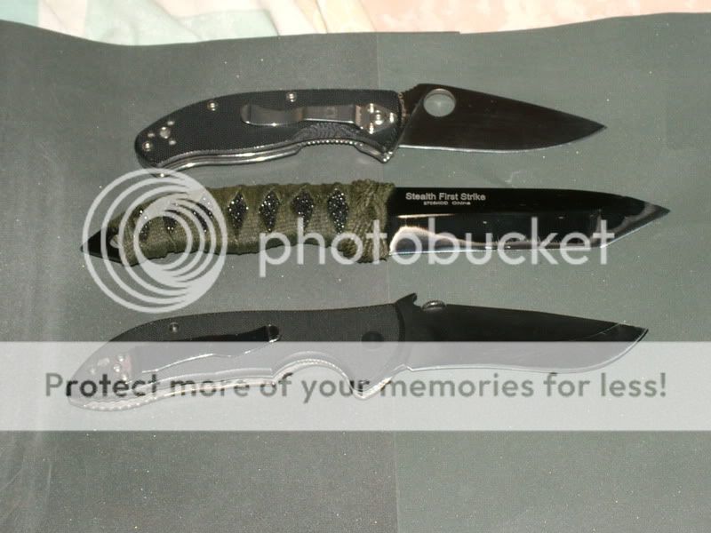

I changed the bevel on my commander using sand paper on a dowel rod for the shaping and a sharpmaker for finishing. Works well but needs a little more use and sharpening cycles to get it properly "right".
This shows the side I had to grind the new bevel onto. Above the Emerson is a CRKT I used to learn how to convex on, and a Spyderco I spent a good bit of time stropping to very sharp indeed!
I want to try v grinding out mine, but lossing that much blade width would change the appeal so i cant commit to it. To do it right I would lose the entire edge bevel to get the degree i wanted.
