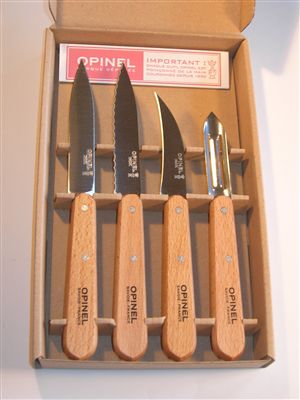

You actually don't need to spend a lot more in my opinion. I have an Opinel bread knife, less than 25 euro, and for smaller tasks I use a Global GS-1 or often the simple Opinel kitchen set (around 30 euro for 3 knives and one peeler):
Your own cooking skill will probably be more the limiting factor than these affordable knives!
