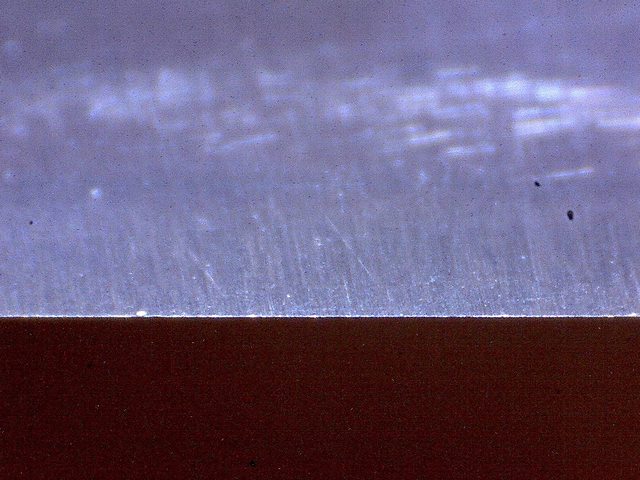

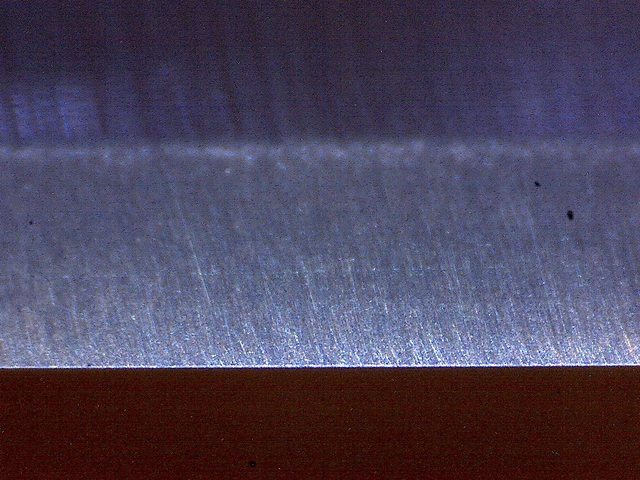

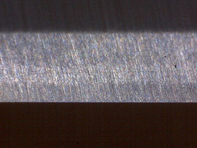

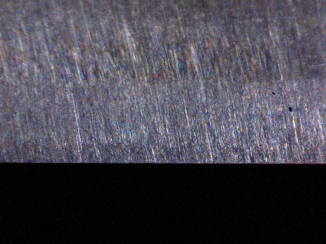

One of my knives sharpened on a DMT EF:
Another of my knives sharpened on a DMT EF:
One of those is a carbon steel Mora that was reground to FFG, and the other is a Spyderco Mule Team in Maxamelt at ~68-71 HRC. To me both edges look the same under microscope examination and display identical push-cutting sharpness and slicing aggression when tested on newsprint and paper towel.
