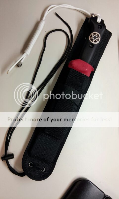

Head and shoulders above the stock sheath! I just ran across it the other day and was suprized I still had it. Thought I threw it out years ago!
The material is good quality, good stitching, havent had any issues with it. Still a pretty robust sheath. Decent for the amount paid for it. I'd buy another if I needed one that size.

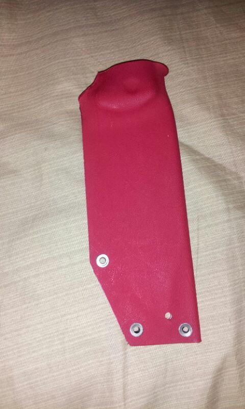

the stock sheath liner can be pulled out by undoing the stitching that holds it, it's not the bottom stitch so the sheath won't come apart. Mold kydex and give it a trim fit, then slather the inside of the sheath with Barge's contact cement and the kydex too, insert and it's good to go.If you are too worried about retention drill a hole at the bottom of the kydex and thread thru the sheath with a Chicago screw, but the cement is quite sufficient.
