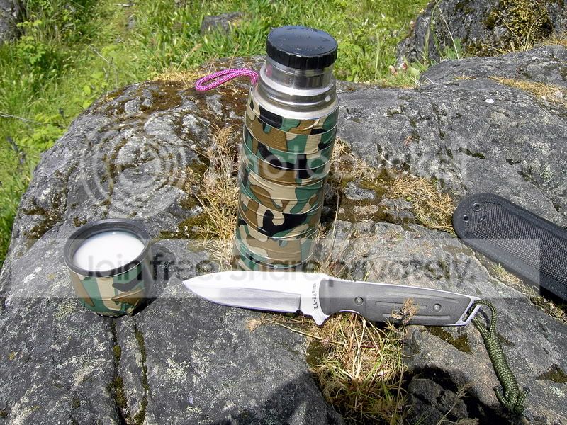

A pic of my knife and my newly camo'd flask, worked a treat, put it down and lost it !!!! JK !
