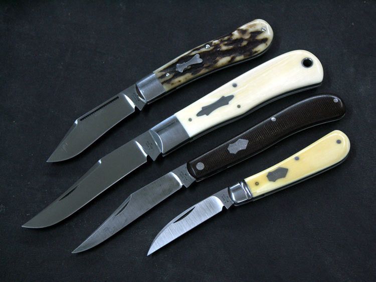

Slip joint in W2
Pre knife blade/s
A little W2
Carbon
Lil' more W2
Bose knives, D2, W2 & 440V
The vast majority of my work is in either W2 or Damascus....But....now and then I
digress, If I use a high chrome steel it's Elmax, or D2.
